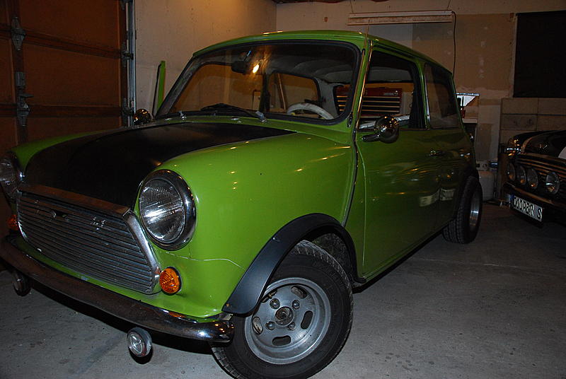

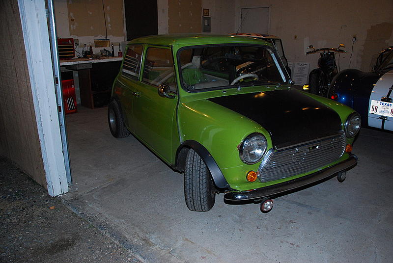

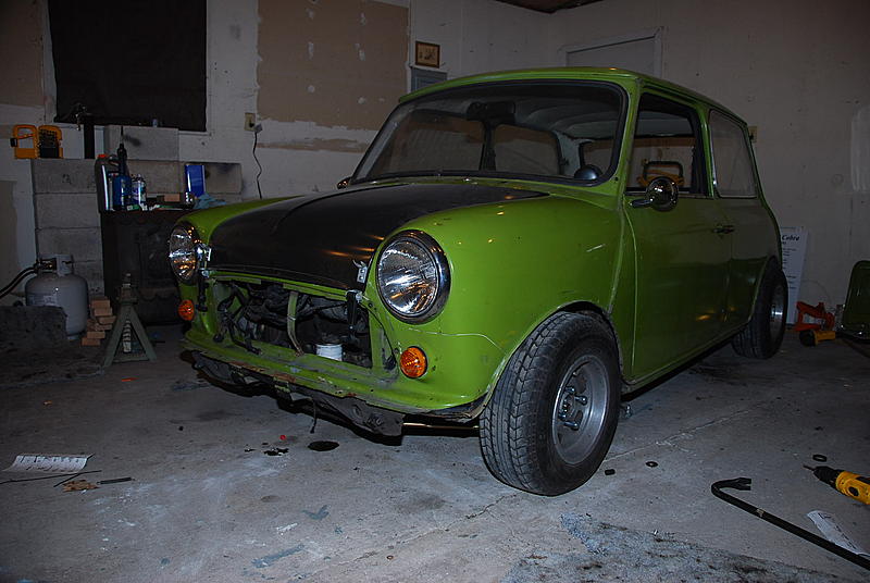

Well here's what I'm starting with.

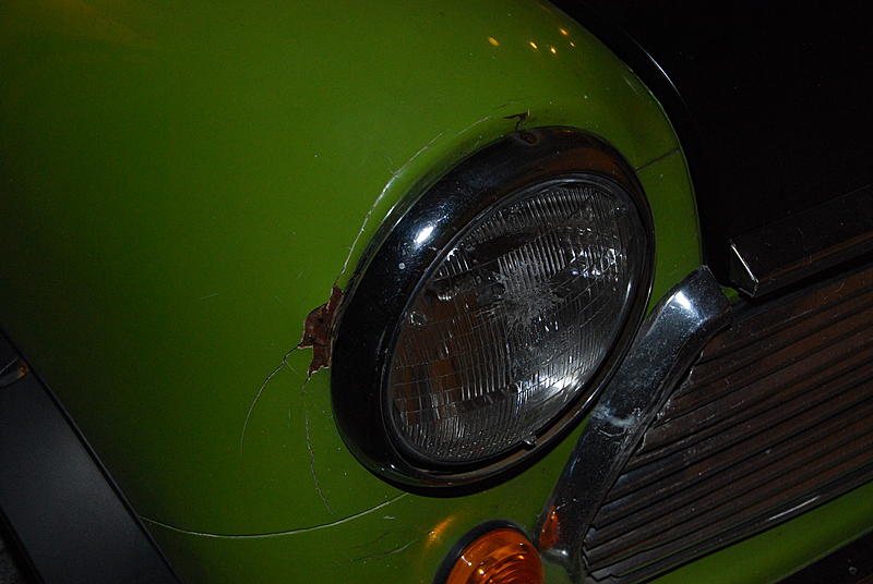

And some more. Not the rust around the head light. This is the only rust on the car.

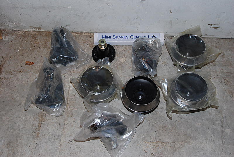

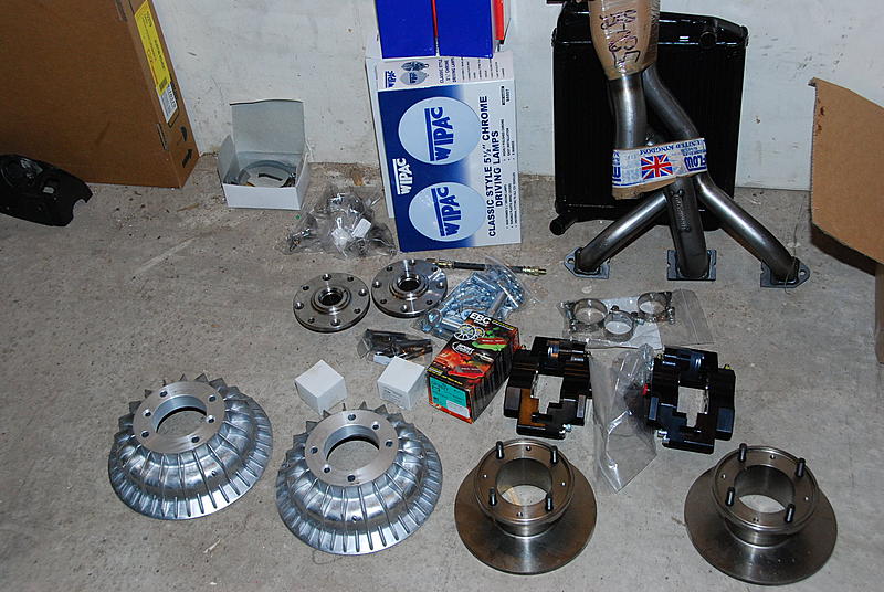

Some of my goodies going into this car
New suspension pieces and new drakes, with front disc brake conversion.

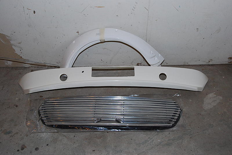

And some new body pieces.

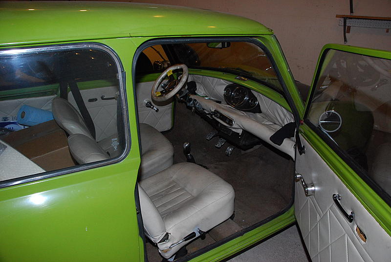

Interior is gutted and I started working on my new aluminum dash. The big hole in the center is for the new spedo I have coming. The three small holes are for three more toggle switches.

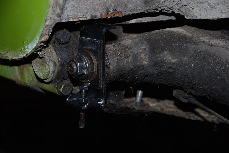

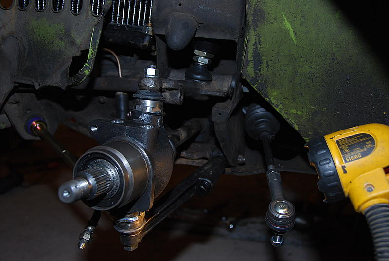

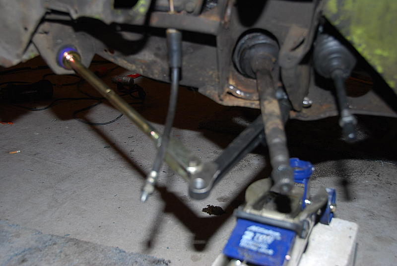

We got all of the old suspension stuff removed yesterday. We're having trouble with the big sub frame bolt on the passenger side. The welded nut in the body came loose so we can't unscrew the bolt. So we spent a half a day cutting and grinding and it's still not out.

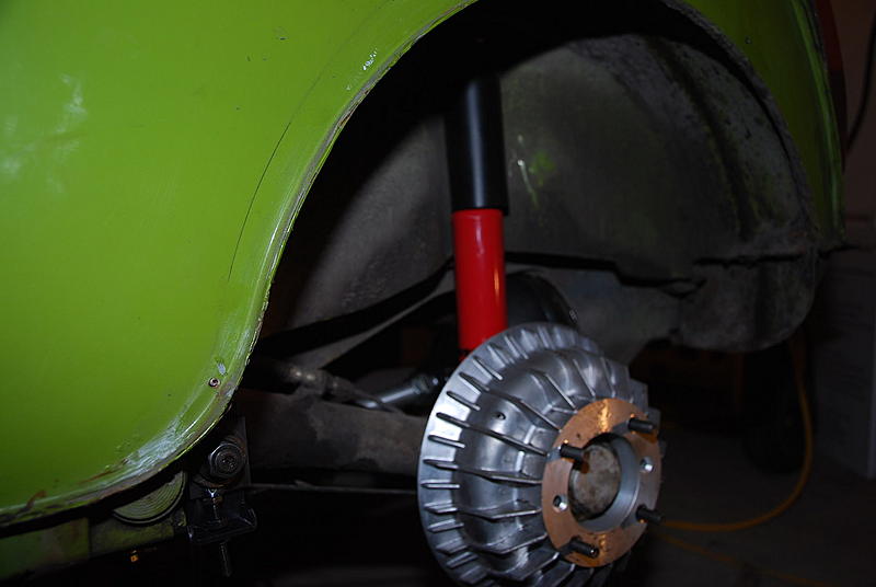

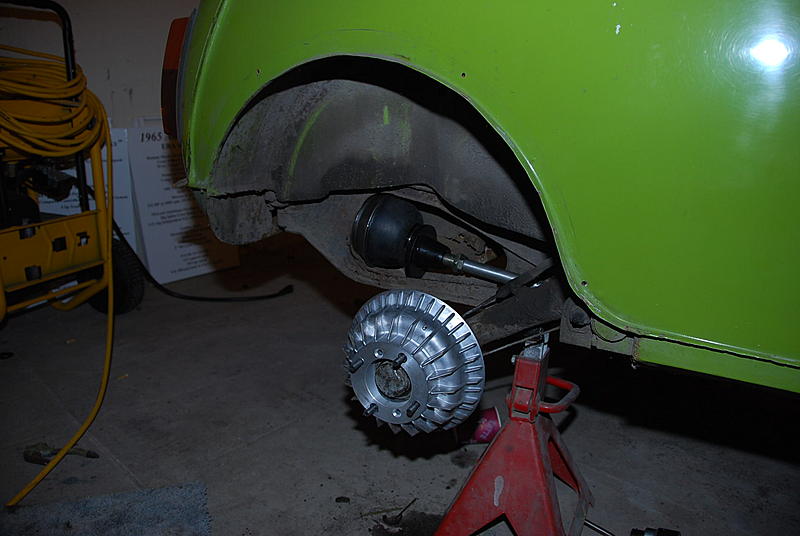

We got the new brakes and drums on the rear, just waiting for the shocks.

All suspension work is done. Got the shocks today and installed the rear caster/camber adjusters.

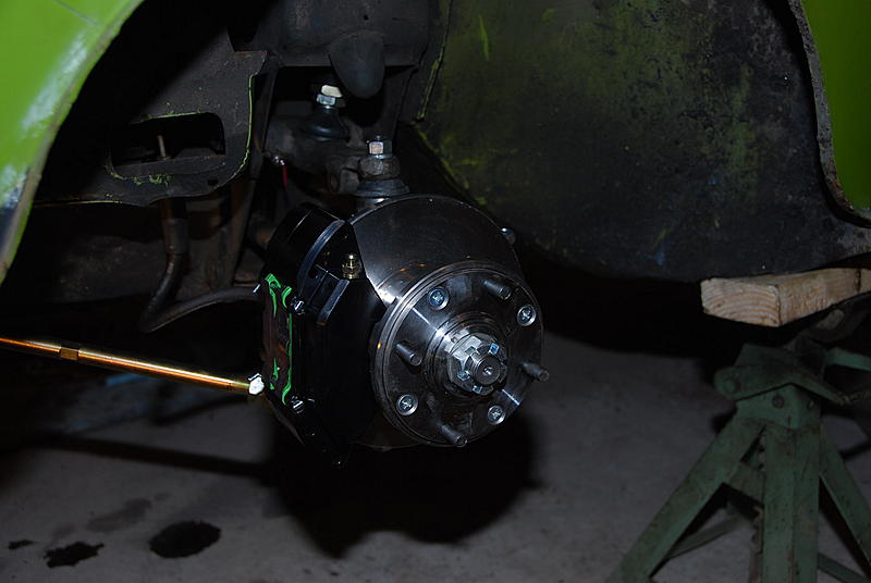

Here's some front suspension pics with my new disc brakes,
