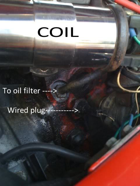

I checked and yes, it's an original Smith's gauge. On the back is a threaded brass fitting.
I also eyeballed the block, and here's what I see (shot taken from the RIGHT side of the vehicle, looking inboard):
Apologies in advance for the state of the engine - this is no pampered trailer queen, obviously...
The wired plug looks like the wrench end of a spark plug - is this the oil pressure sender unit?
If so, how do I tap into this plug such that I retain the electrical connection (if needed - I assume it will light the red
ignition" light if pressure is low) and also add in the mechanical connection required by the old gauge? Is this where I'd use the "T" gauge you mentioned, or is that an ELECTRICAL junction?
LMK if you need a photo of the back of the oil pressure gauge to confirm the mechanical hookup.
Thanks as always!!!!

You need a T-fitting, that will screw into the block in place of the oil sending pressure unit (Yes, that's it in your pic) then you plumb one end of the oil pipe into the T and screw the oil pressure sending unit into the other, that way your idiot light will still work (although you don't really need it anymore as the gauge will tell you far more accurately what's going on) and the gauge will also work. Take the other end of the oil pipe up to the gauge and hook it up to the gauge. I believe the thread size is simply 1/8 pipe thread.
You need to buy a T, a 1/8 close and the oil pipe to the gauge. Like I said before, whichever Mini parts place sells the oil pipe will most probably have everything else you need to do this too.
