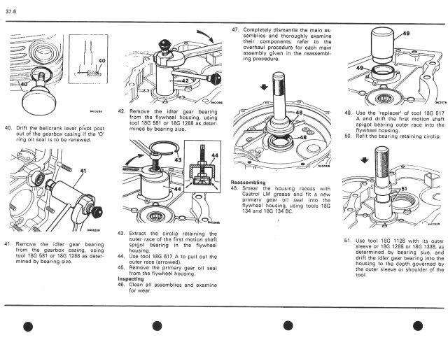

What is this? (Sorry about the picture size... I haven't learned how to change that yet.) It looks like some type of plug... but the Haynes manual doesn't mention it. More investigation will be required as to where the leak is coming from, of course, (unless the answer *is* "everywhere) but for now I am just curious if anyone knows what this is or how one would fix it if it was leaking.

About that leaking plug.....I've got to look under the car.....OK yep I have something similar and after a long search I think I've identified it. Here's a page from the 76 to 85 Service Manual
Top left - step 40 - this appears to be the 'bellcrank lever pivot post' and is only removable by drifting out, I guess from inside the pan while disassembled???? I haven't found a part number yet. Mine appears it could be weaping there too but I don't see an easyway to get that out to replace the o-ring. Ideas anyone??? It could be weaping here, or being a low point it is just where other leaks finally run down to.
My suggestion, not unlike others, is CLEAN EVERYTHING OFF then you'll see where the new oil comes from. I bought a small steam cleaner and it is worth its weight in gold. A couple of hours in the garage with hot steam and my engine bay is CLEAN without all the electrical problems a pressure washer causes
