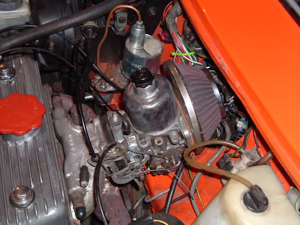

I guess that on an SU setup the equivilent is removing the stock airfilters and replacing with a cone...which is what's on the end of a CAI....
Here's what was on my 79 when I got it
Note that making this change and increasing the airflow means you also need to change the needle on an SU carb so you want to discuss the particulars of your setup with the vendor.

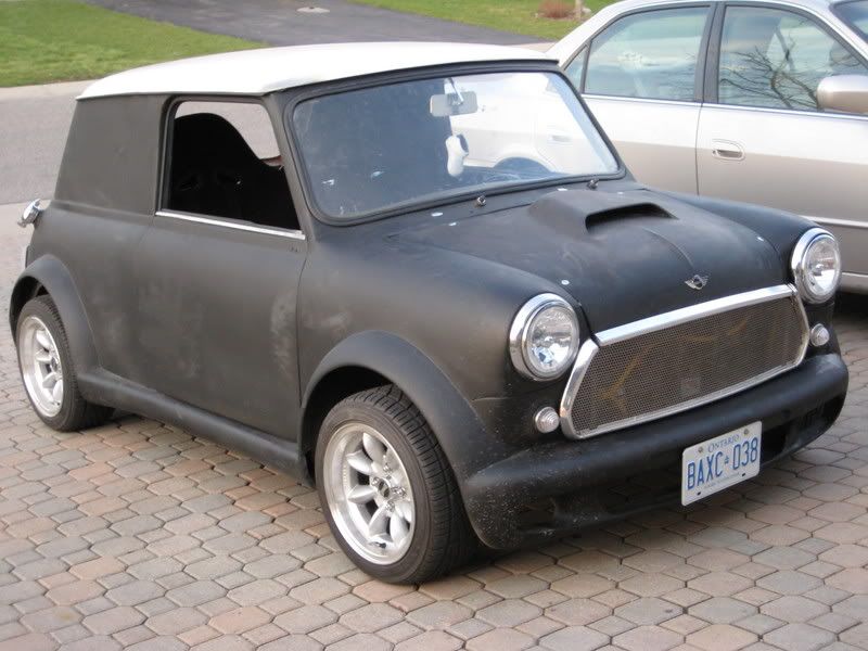

And then I guess my setup carries this a step farther. I've a plastic front clip and no inner fenders....I got air flow out the wazzoo. I'm not sure any ducting would help. (pic with the clip removed...not much to impede airflow here!)

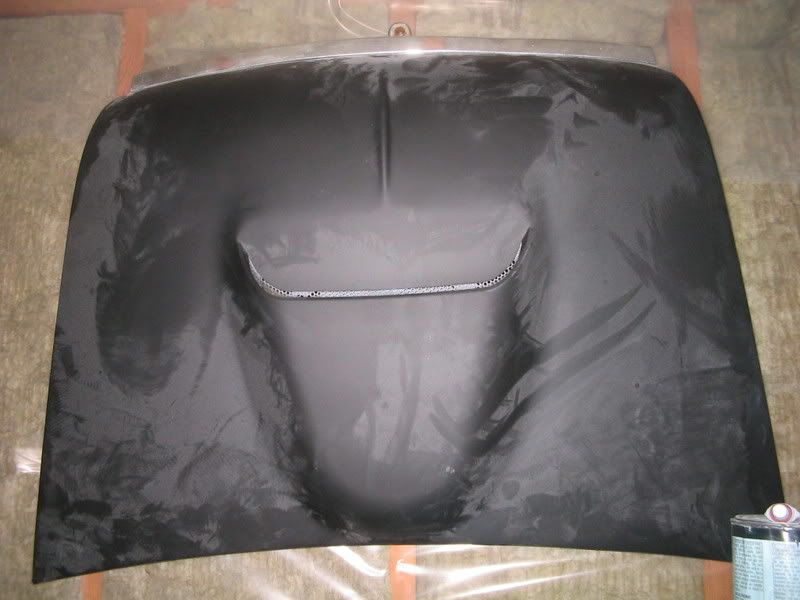

I've got a ram air hood on my mini that will allow cold air to my carb.

pictures?

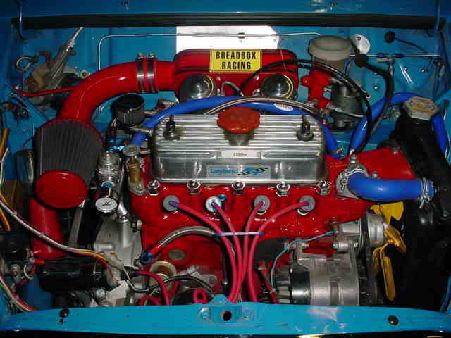

This could be another option:

Damn thats clean... and kinda my idea. Having it more forward and/or with a heat shield would be better
