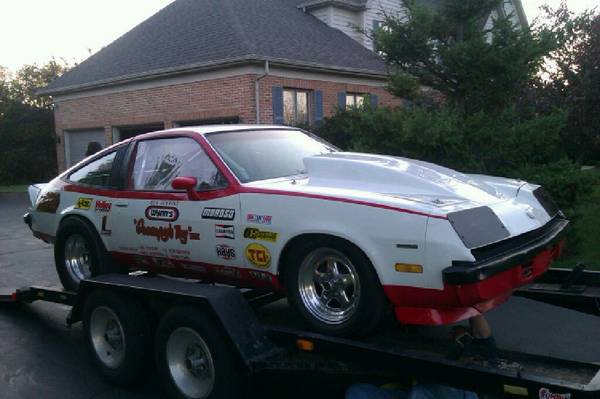

Thanks ill check them out that’s not far from me im in the west suburbs so i can take a ride up there for them. I found a decent trailer is 16' with a 3' toungue (not sure what that is?) but im going to take a look at it tomorrow it has new tires and a winch. It also has no middle just the tire rails so it should be lighter for my truck to pull. I attached a pick of it but its not really a good one lol

Hey, check the "open pit" length.. I dont think the MINI clears an open rack trailer. I've been through 3 car trailers at this point, only due to a couple stupid drivers that forget to stop sooner when the BRIGHT yellow truck is towing a trailer!! I've yet to find a 18-20 foot car trailer open center that the MINI can clear, and not fall through!!
The 3ft tongue is normal, but some trailer dimensions usually include the tongue in the total length, which makes that trailer only about a 13.5 - 14.2 foot deck. long enough for the MINI but the open section will make it a PITA if you can actually get the MINI on the trailer. Be sure to bring your truck and the hitch ball you plan on running, to check for rear trailer height clearance when attached to the truck.

Thanks for the info! im suppose2 check out the trailer tonight i just got my roll bar in last night man that is a PITA! lol ill look at all of the clearances, so than this would technically be a 19ft trailer?

It depends how the guy that measured the trailer told you. usually people will only measure the deck the car rides on as the trailer length. my guess says that is a 18 ft trailer. most companies dont make 19ft trailers, only 16, 18, 20, 22...
