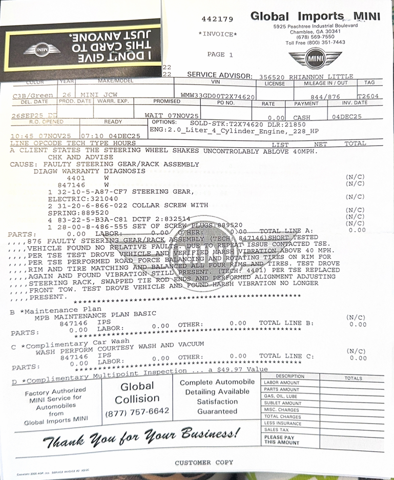

So far, the only solution is replacing the steering rack under warranty. Below are a few links to others with the issue, as well as two service receipts from people who had the issue fixed with a steering rack replacement.
Links to others with the issue
2026 Mini Cooper JCW 180 miles/Vibration : r/AskAMechanic
2026 Mini Cooper JCW 180 miles/Vibration : r/MINI
John Cooper Works | I just purchased a 2025 Mini Cooper JCW 2 Door | Facebook
MINI U25 Third Generation Countryman Group | We have a new 2025 MINI Cooper JCW | Facebook
Service records of this being diagnosed and fixed

Some updates. Today I drove the car about 70 miles, a mix of backroads and 80+ mph freeway. As we already knew, my oscillations can be triggered by turning the wheel a few degrees to either side and letting it go back to straight while driving in a straight line. Not even enough to make the car react, kinda in the dead zone of the wheel. But today I realized that hitting small sharp road imperfections at higher speeds triggers it.
Some of the times it started oscillating it was bad enough that the car sounded like it was riding on some serious rumble strips, and all the mirrors were very blurry. Turning the wheel either way didn't make it stop so I had to slow down below 10mph for it to stop.
The day I brought the car home I emailed my local Mini dealer and I got an email today from the service guy. He said this:
Good afternoon! This is Robert over at Mini, and I was emailing to see when you wanted to come in to take care of the vibration issue on your Mini. I've seen this before and it should be covered under warranty, and I would recommend reserving a loaner since Mini takes awhile to get back to us on warranty stuff. You can email me here with any questions or when you would like to come in!
So I called him and he immediately told me that this is becoming a known problem with the 2025+ JCW Minis, and that they have already repaired a handful of them including one of their own loaner cars. He stated that so far every time it has been the steering rack. He went on to tell me that he had the aformentioned loaner for a few days and the vibrations are "something else" when they occur. He then said that the part is currently a special order part but they are expecting the part to be made much more easily available as time goes on since the issue is becoming so prevelant.
Finally, he told me that since they already know what the issue is they shouldn't have my car for more than a week and they already have a loaner lined up for me to take upon dropoff.
Of course, I will see if all of this holds true when I actually bring the car in, but so far I am shocked with the response I have gotten to this problem. All of my past dealership experiences have been hell so if they stay true to their word this might be the first positive dealer experience I have ever had.

Brought my car in to mini today and talked with the service manager. He told me that even without looking at it hes pretty sure it's the steering rack as they have seen it on multiple other '25 and '26 cars recently, including one of their own loaner cars. He said that they already have a steering rack on the way for their loaner but my car is priority so they will most likely install it in like when it arrives this week.
In the meantime I have a 4 door cooper S with the JCW appearance pack, but it most certainly doesn't drive like the JCW 😂 although I must admit the smoother ride is kinda nice. I wonder if I can put cooper S springs on the JCW...

Received word from mini today. They were able to replicate the issue and are waiting for the warranty department to greenlight the fix. As mentioned, they reiterated that they have had multiple cars come in with this issue including their loaner so getting it approved shouldn't be an issue. The rack for the loaner arrived early so its possible they will install that one and have the car back to me by Friday, otherwise worst case is mid next week. I was also getting lots of squeaks and rattles from the window seals so they cleaned and applied some compound to the seals to help with that. If not I will stick to my plan of using Sonax gummipfleger.

Service advisor contacted me about an hour ago saying that Mini has approved the rack replacement and the car should be done Friday, but potentially Monday depending on how things go. So about a 1 week turnaround time, much better than I was expecting seeing as other people online had their car in for 2-4 weeks while Mini sat around doing nothing.
