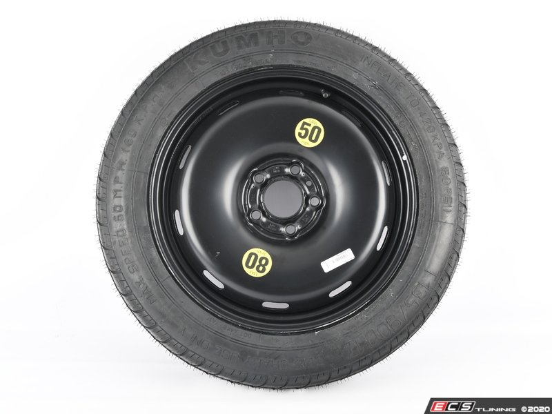

We have it here but with a shared BMW tire 135/90r17. So its a little taller, hair wider on the MINI oem wheel. I dont know how much extra room is in their for the larger tire if you store it. I have not seen any pictures of the storage point.
https://www.ecstuning.com/b-assemble...36116851507kt/

Yep and that tire is only about 5.31" wide on bead to bead.

A 135/90r17 is 26.6" ... so I am not seeing how it would fit in the lower storage area.
Old Oct 21, 2024 | 01:46 PM
Posts: 36,719
Likes: 2,537
I am talking about height when laid on its side. Did not calculate the width of side to side when laid flat.

Hello, We linked a spare above in the small tire/steel wheel form. You would have to deflate the tire a little to fit it in there. But its the Genuine MINI/BMW steel wheel.
