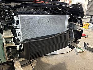

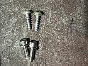

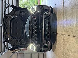

The new intercooler arrived and I was excited and anxious to start the install. The first obstacle was trying to identify how to remove the bumper on the F60 Countryman. The instructions that are provided by Forge and other videos I found on Youtube focus on the F56 models but using those instructions, I was able to work my way around and remove it with little to no problems. Honestly the hardest part of that was holding the bumper with one hand while unclipping the wires from the body and the fog lights. I used a parts divider tray to store and organize the hardware as I removed it and labeled it accordingly to assist me when putting it all back together.

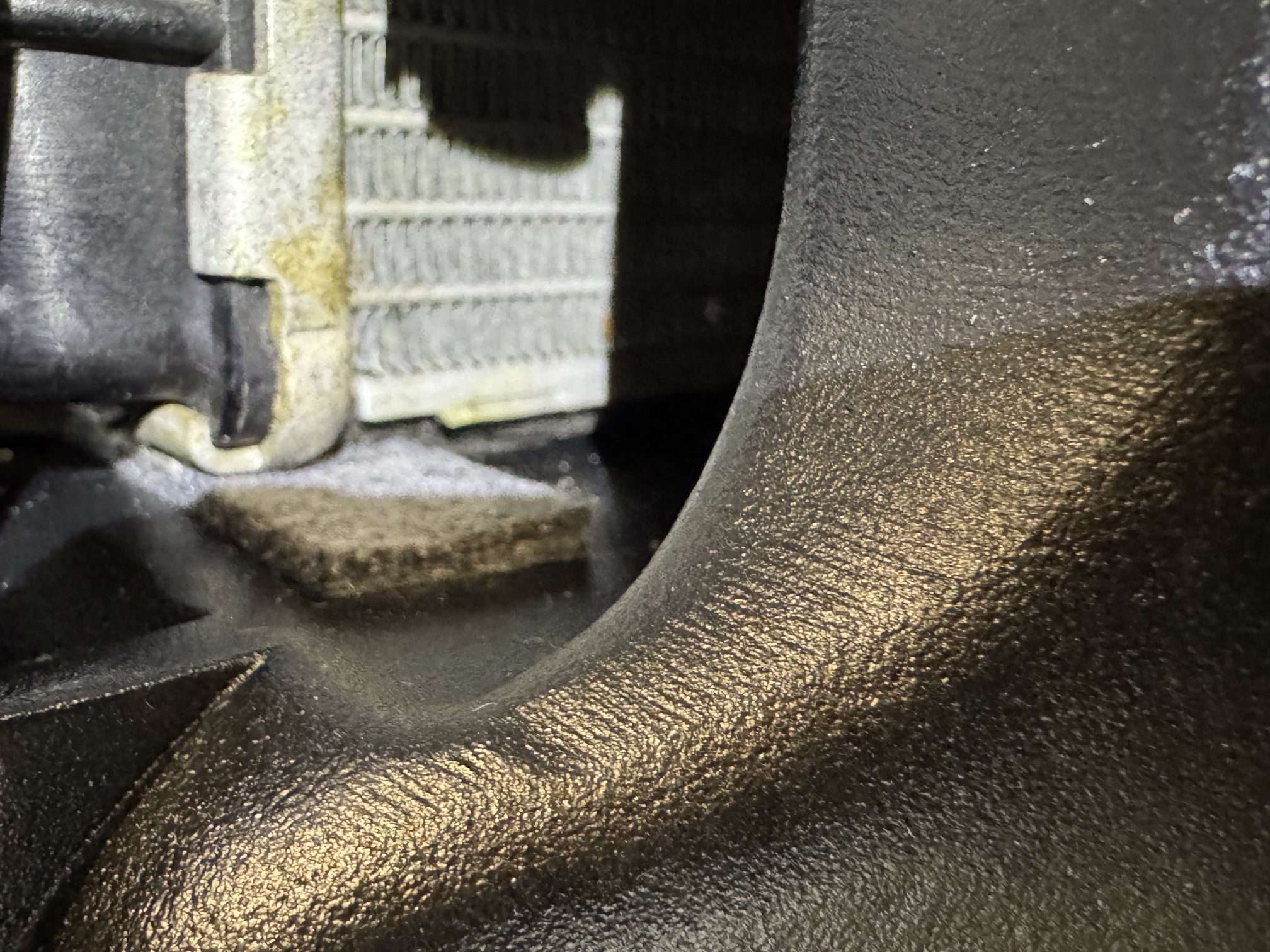

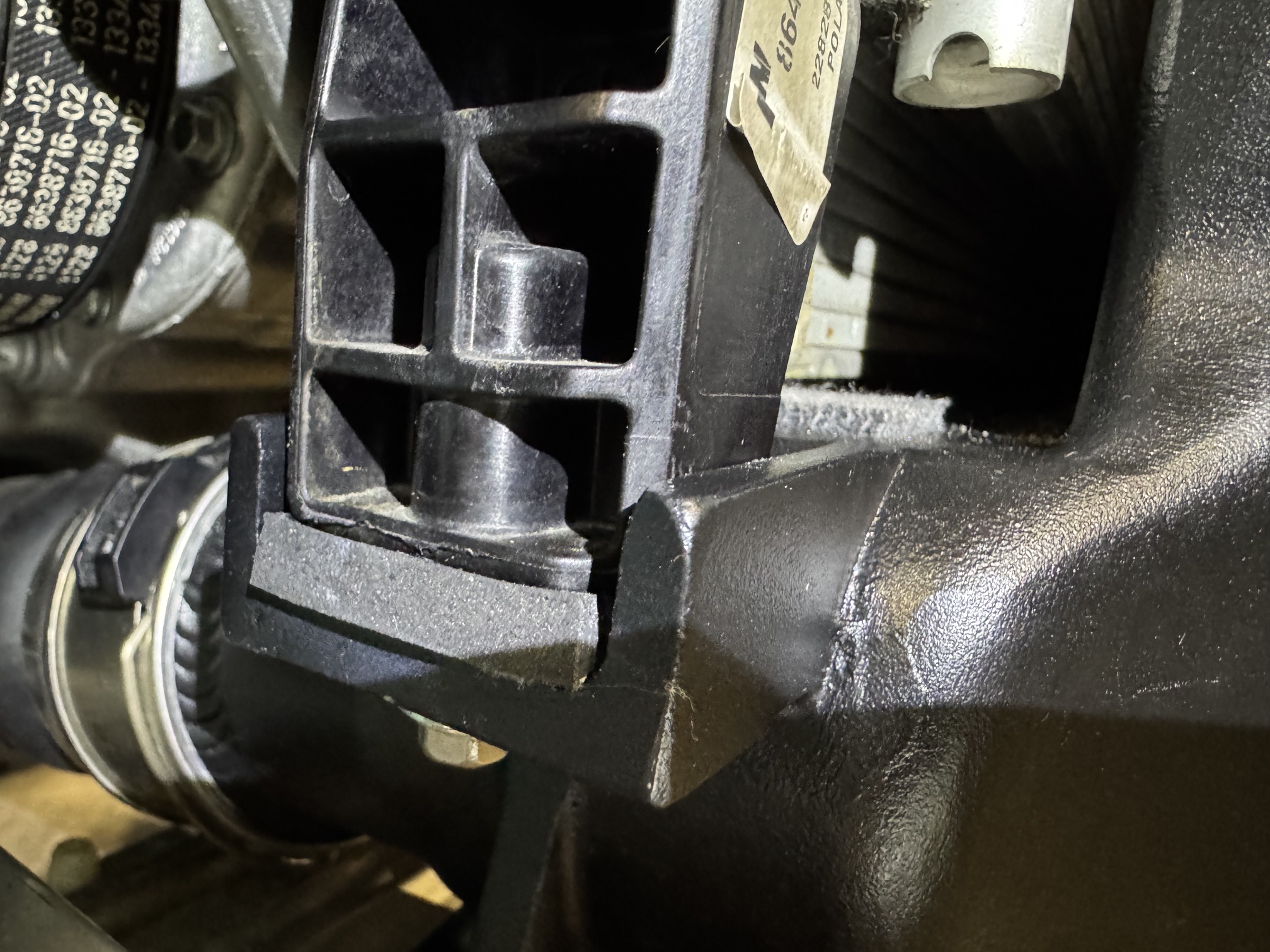

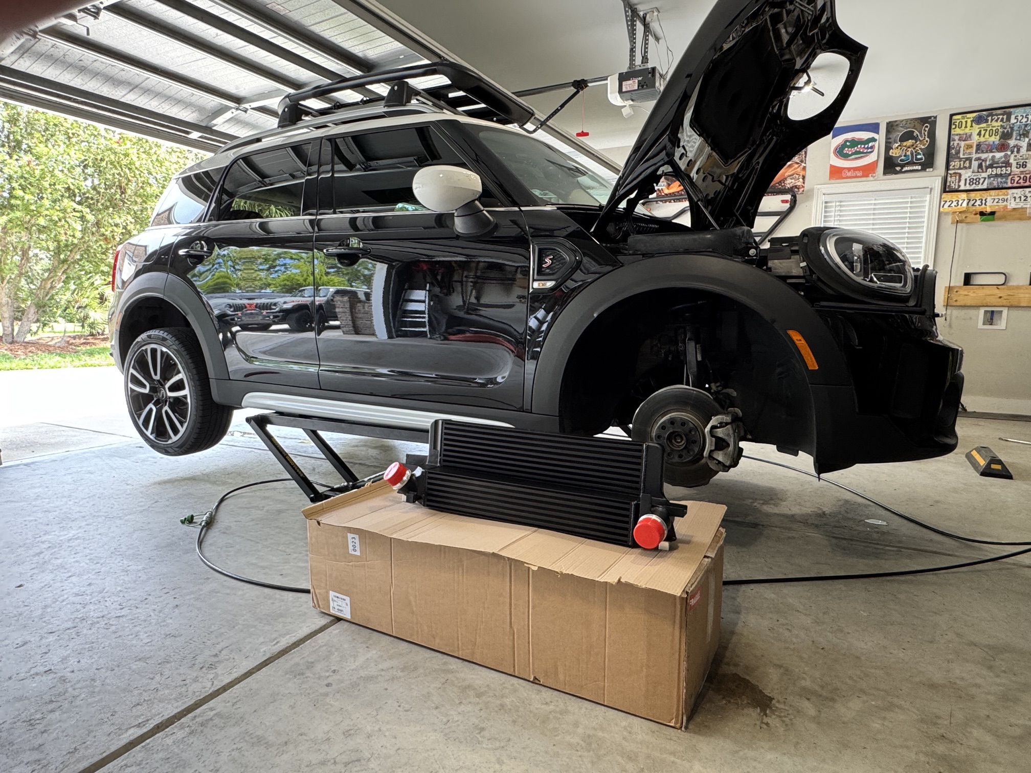

The removal of the OEM intercooler was seamless with no issues but the challenges started to present themselves as I installed the new intercooler. The first then that came to my attention is that the radiator mounting pegs do not fully seat in the wedge tabs of the new intercooler. I double checked to ensure the slots on the backside of the radiator fully seated on the holding points of the intercooler but then discovered that the bottom of the radiator has a foam padding and there's also points on the radiator that are lower than the foam padding that make direct contact with the intercooler. Realizing I would need to leave a gap in the tab wedges and use spacers, my plan was to use 1/4" rubber durometer pads in that void on each side where the radiator mounting points would seat to keep the radiator from making contact with the intercooler. Because I used spacers, I would then need to procure longer screws that secures the radiator to the intercooler. I would have had to get different screws regardless because the replacement screws that come with the intercooler are not the same design as the OEM screw. Forge provides an M6 metric screw but the OEM screw is a self tapping coarse metal screw designed to thread itself into the plastic housing of the radiator. So essentially I had to make a hardware run store for the longer screws and while I was there I found Green Egg High Temp Felt Strips and placed it on top of the intercooler where the radiator would make contact for added protection between the units. This is the felt strip padding that goes on the inside of the grill where the lid makes contact with the bottom. Who would've ever thought....

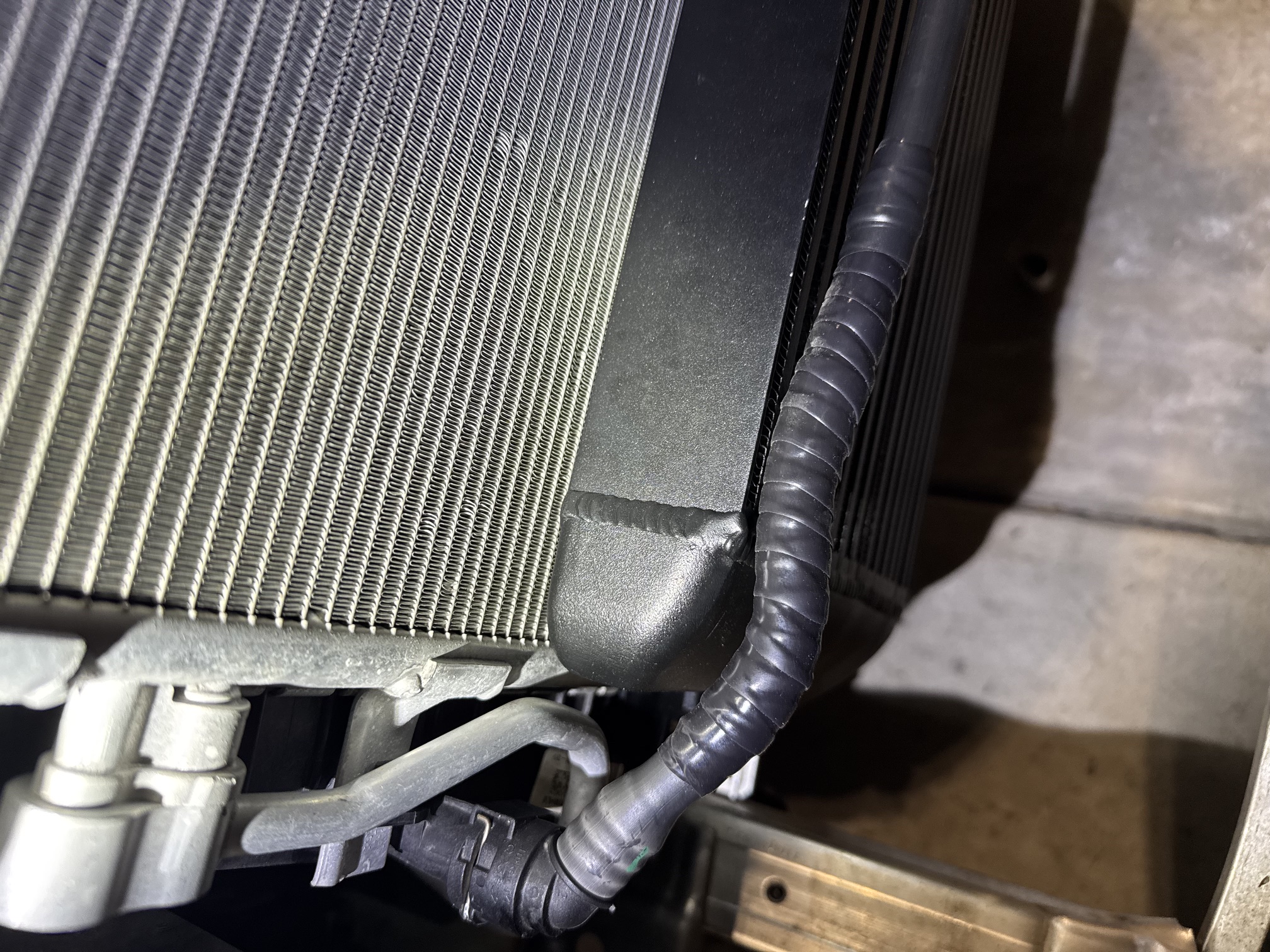

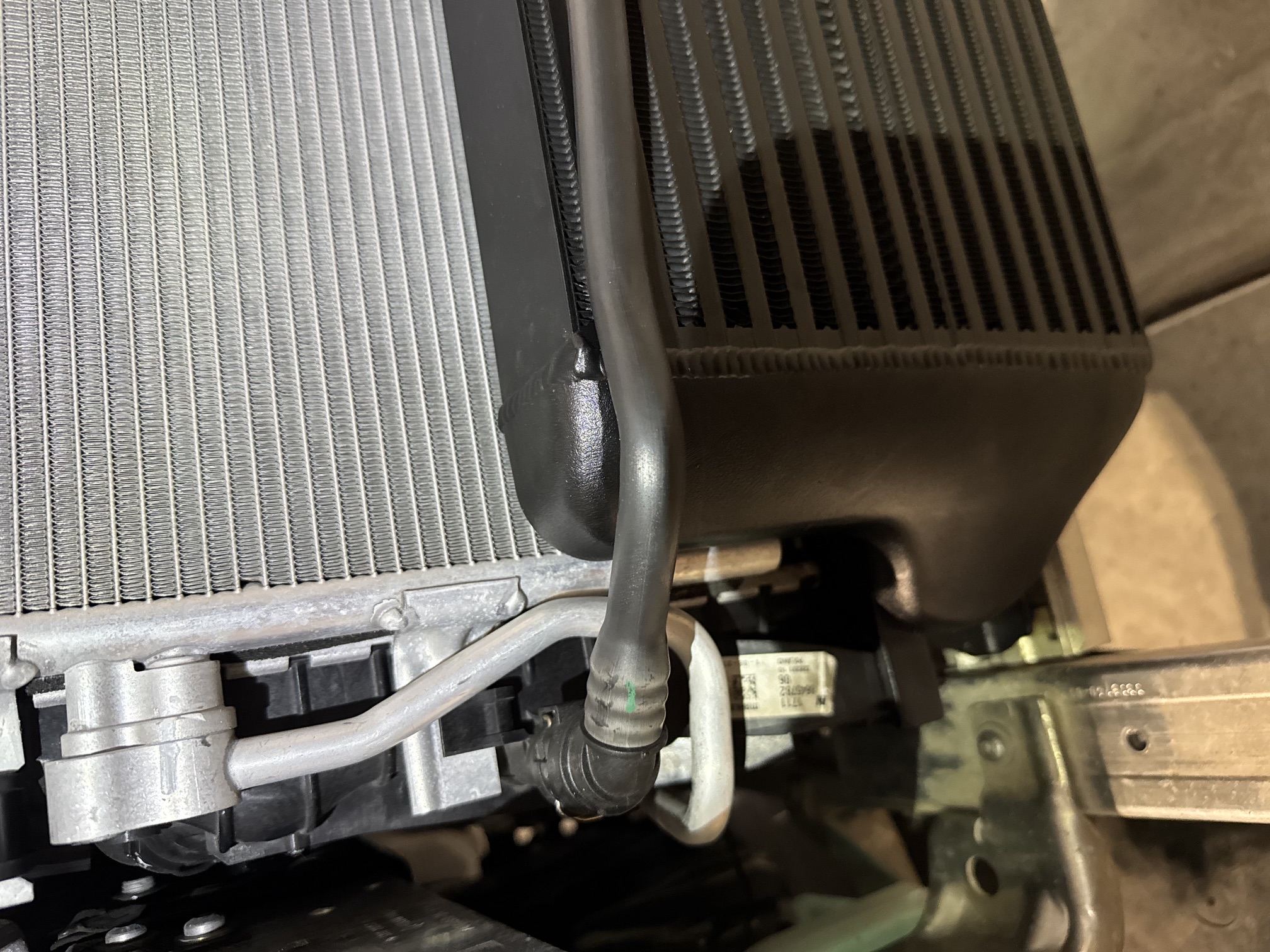

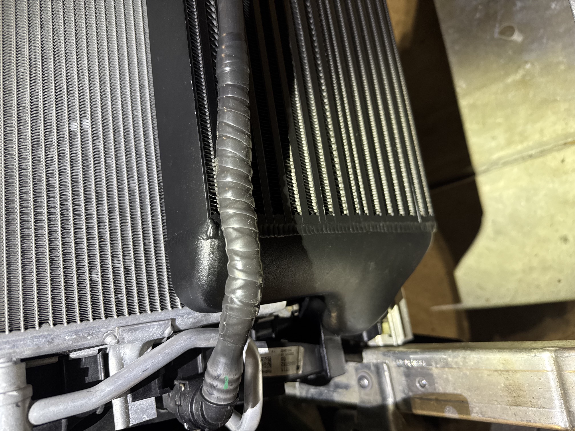

The next challenge to overcome was how to properly route the hose for the auxiliary radiator with the new Forge intercooler. Since the OEM intercooler is much shorter in design, the hose was able to be routed over the top with no tension on the fittings of the main or aux radiator. Unfortunately, due to the design of the Forge being taller, the hose cannot be routed over the top as it puts tension on the main radiator plastic fitting. The best course of action was to route it in front of the intercooler and then double wrap the hose in silicone tape in the area it makes contact with the intercooler to cushion it and prevent abrasion.
Although the installation took longer than expected due to the obstacles to overcome, I'm still impressed with the build quality and the level of customer support Forge provides. After everything was put back together, I started the car and let it run in the garage for 10-15 minutes just to see if anything was abnormal. I was specifically looking to see if the hose being tight against the intercooler was going to be a problem and checked to see if that fitting was damaged. I didn't expect it to be even though it's tight. But honestly there's a bit of play which lowers my concern. Worst case scenario, if I ever think it will be a problem in the future, I'll find a way to delete the auxiliary radiator with hopes that the main radiator will provide sufficient cooling properties. Not sure if the Pre-LCI models have the same aux radiator or a different main radiator.

***for those wondering about the lift, that's the QuickJack 7000. That the lowest setting in the picture and the height was perfect for this job. Definitely makes it easy to work on all our vehicles to include my truck easily***
