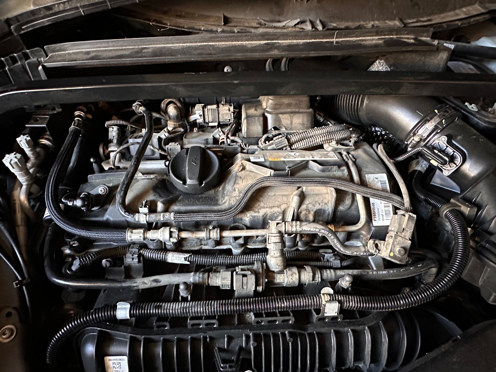

2018 F60 spark Plugs

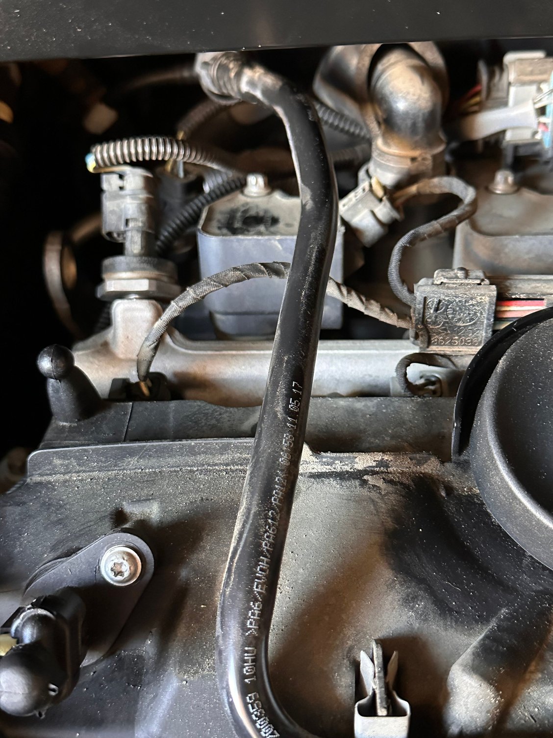

Hello! I am also looking for DYI info on changing plugs for my 2018 F60. I have the tools. #1 plug has a vacuum hose over it… is it safe to remove? Also there is some kind of stability bar making it tricky. Any tips on doing this yourself?

I replaced my coils and plugs on my '19 F60 S. I did not remove the vacuum hose and was able to work around it... You do have to move the foam covering over the two coils on the right. I just moved it out the way. I also didn't remove the bar.

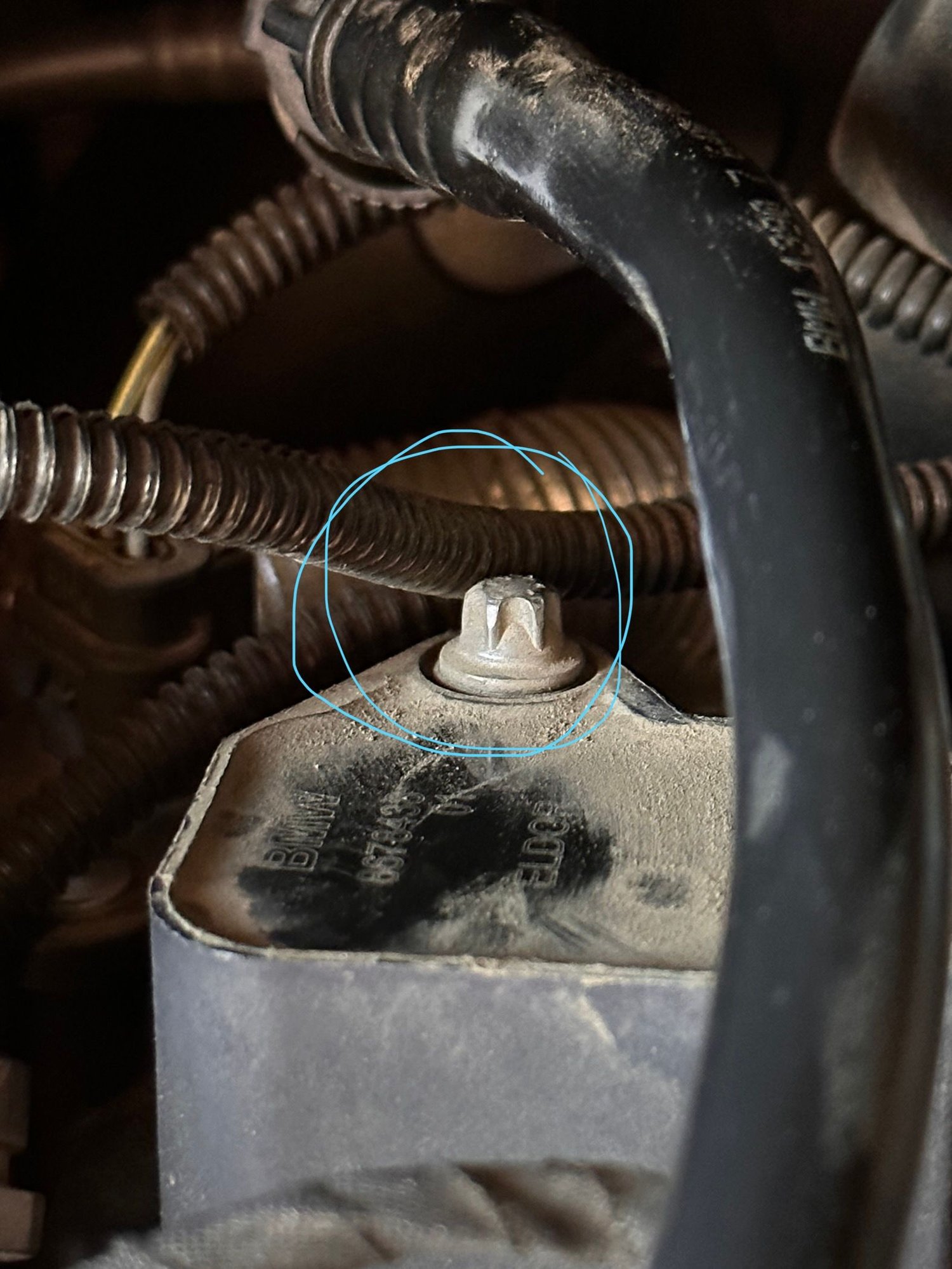

Great, thank you. I’m new to mini… Did you need a special socket for the coils? It looks like this nut is securing it.

I figured it out- I haven’t had to use torx much before.
