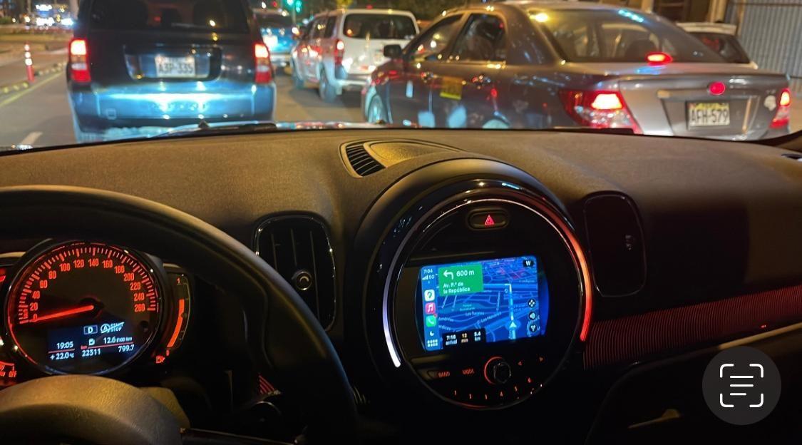

Here it is
Baby got back
Main passenger... always with me...
So you can get an idea of my dash

I think you have a bigger CarPlay display since it's full screen. By default the 8.8" screen doesn't have full screen CarPlay and only uses about 2/3rd's of the screen. If you retrofit the screen make sure you have full screen CarPlay still coded in.

You are correct... This 6.5" display opens Apple CarPlay "full screen"... I was not fully aware that originally the 8.8" kind of splits the screen to fit the original ratio of the CarPlay display (what a silly thing!), but you are spot on, it is not just a HW upgrade, but involves an ID upgrade...
