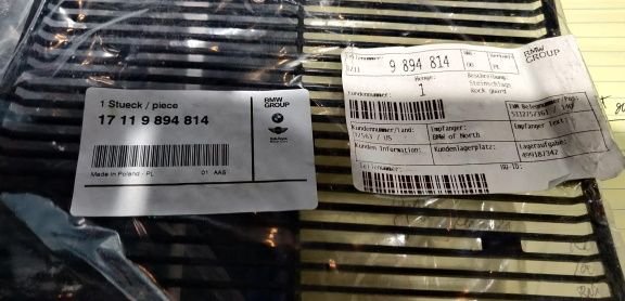

Old Aug 13, 2021 | 02:34 PM
ApexF60SE's Avatar
ApexF60SE
Joined: Dec 2018
Posts: 107
Likes: 31
Chalk another one up...
Earlier this week communiting home in 96F temp. Engine overheated, towed to dealer. Dealer wanted $1,200 to replace the aux radiator and it would take ~6 days b/c they would have long lead time getting the part.
I got the car home (hybrid - just charged it up and drove home). I pulled the radiator, took it to a nearby radiator repair shop (Note a repair shop, not a radiator replacement shop. Actual radiator repair shops are a dying breed.) They pressure / tank tested, identified leak, steam cleaned and applied a polymer seal that is like solder - use a torch to heat it and melt into the spot - for aluminum radiators. They did this in an hour, charged $57.
Removing and replacing the radiator is simpler than i thought:
- Jack up the car, put in a jackstand.
- Remove front tire
- pull 5-6 screws and a couple of pins holding the wheelwell liner in place. Note the liner wraps around under the front of the car. Take your time and it comes loose pretty easily.
- Take out 1 screw.... yes 1 screw holds the radiator in. The bottom of the radiator has two posts that fit into holes on the bracket. Take the bolt on the top Rt side of the radiator out and the whole thing lifts out and there's enough hose flexibility that you can pull it slightly down to work on it.
- Pop off the 2 quick release hose fittings. Use a screwdriver to pull back the wire bail on each fitting. Then just work the hose end off. Once you get it started it really pops off.
- Reverse to assemble.
I was thinking that I may have to jury-rig up some way to apply leverage on the hose fittings to get them to slide back on, but it was as simple as holding the fitting in my left hand, pressing in the radiator with my right and the fitting popped right back on. Close the wire bail (could do that at the start) and it is locked into place. I was also pleasantly surprised that after I put coolant in and heated it up the fittings didn't leak.
Pics below for some indication of the process.
The saddest thing about all of this saga.... I had read this thread months ago and said - yeah, gotta do this. I bought the grid but had set it aside for the next major maintenance. It was simple enough that I spent more time waiting for the tow truck than installing the grid. Do It Now.
Looking around for buying a new part I also noted that they won't sell the replacement radiator without the screen/grid. So somebody is thinking...
Red Circle is the one bolt that holds the radiator down. Remove it and the radiator will lift up and off.
Polymer repair... i had my doubts, but it has held now for multiple 1+ hour drives.
Closeup of the 'bail' holding the quick disconnect. Pry the back straight out with a screwdriver. It doesn't need to be removed, just backed out.
Repaired radiator with grid in place. Fits nice, huh? Note the posts on the bottom that drop into holes on the bracket.
Closeup of the part number for the screen.
If you don't have this on your car, you will need it. It is not an 'if' question... its a 'when' question.
Part 17 11 9 894 814.
