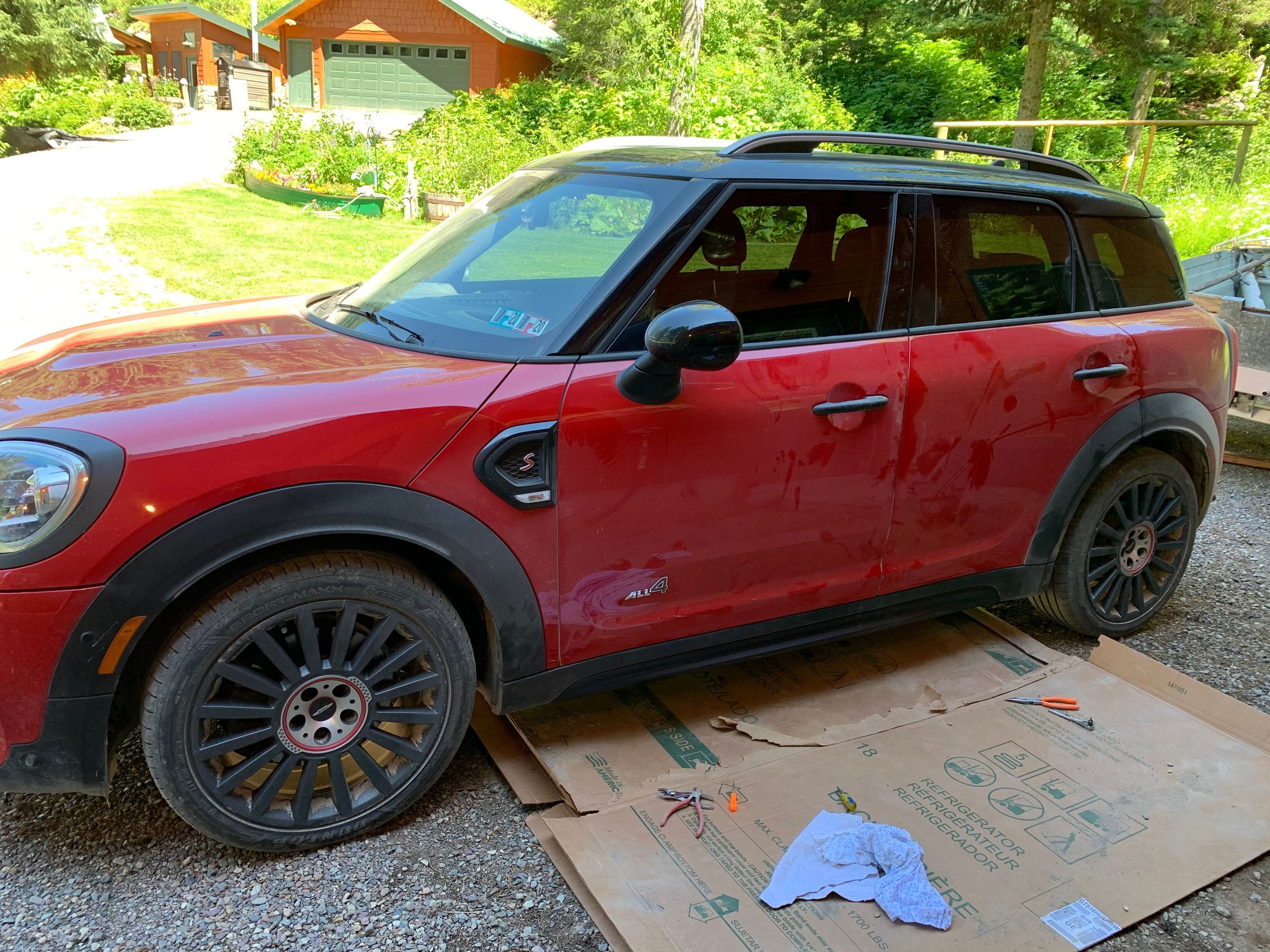

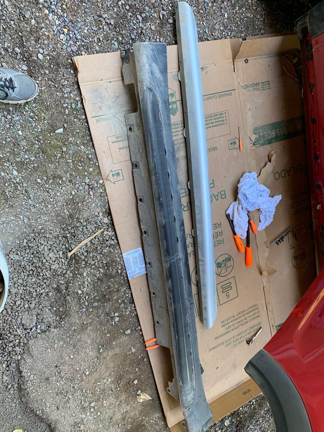

just wanted to give you a heads up, I just removed the silver part to wrap it and it isn’t that bad at all. Just make sure you order 6-8 of the little plastic screws for the bottom because you’ll likely damage them trying to get them out. And use some small pry bars wrapped in a towels to pry the trim away from the body. Once the whole black part is off, you can pop out the pins that hold the silver part in and press the tabs out from the inside. The black trim piece can now be reattached to the car while you wrap the silver part since you only have to press it in and push the pins back in.
You’ll need an 8mm socket, SMALL flathead screwdrivers (but bigger than eyeglass size), a few small pry bars, a trim removal tool, and a T10???? bit for the small trim screw behind the rear door.
