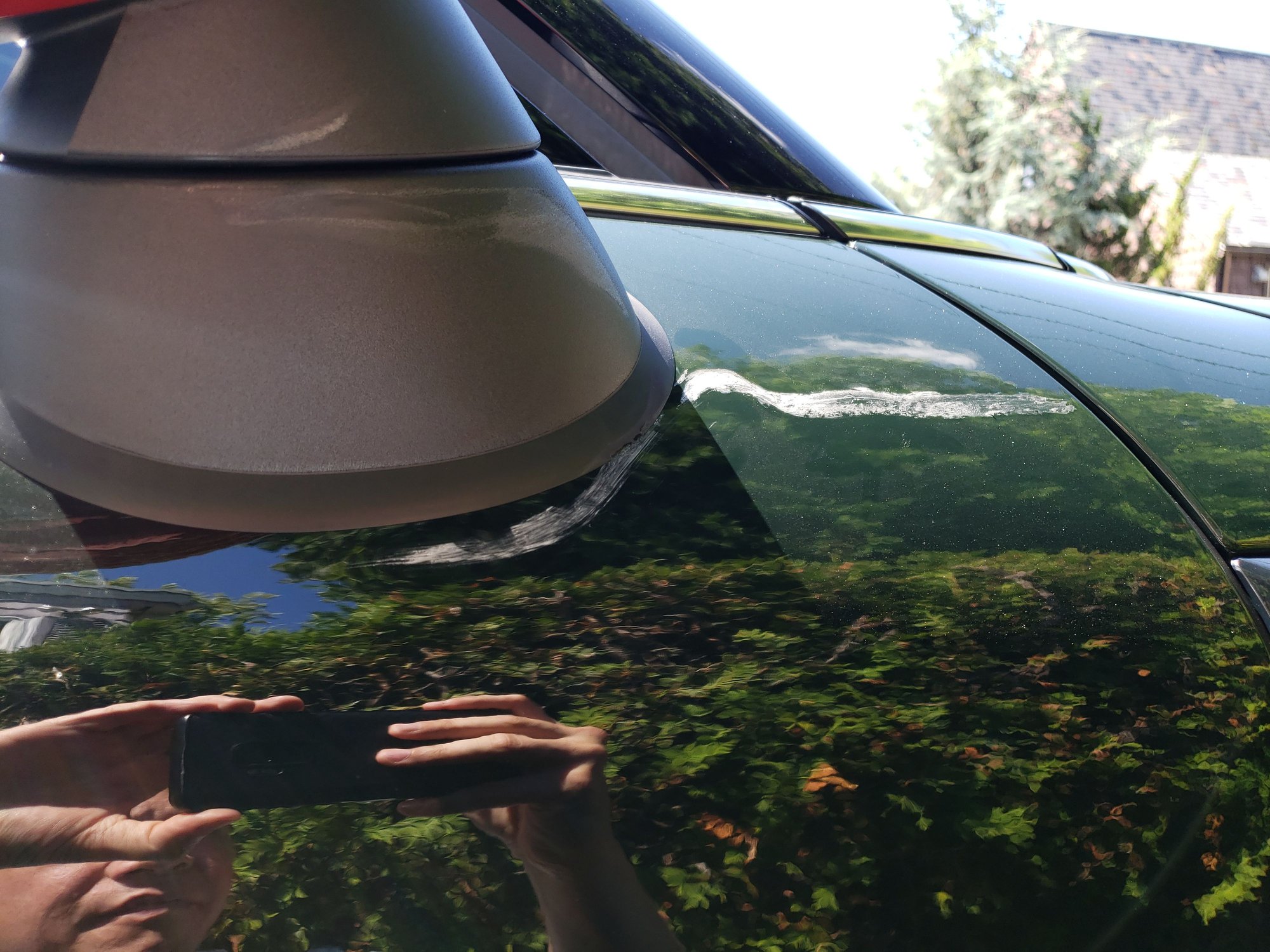

This went down to the primer...going to need repair.

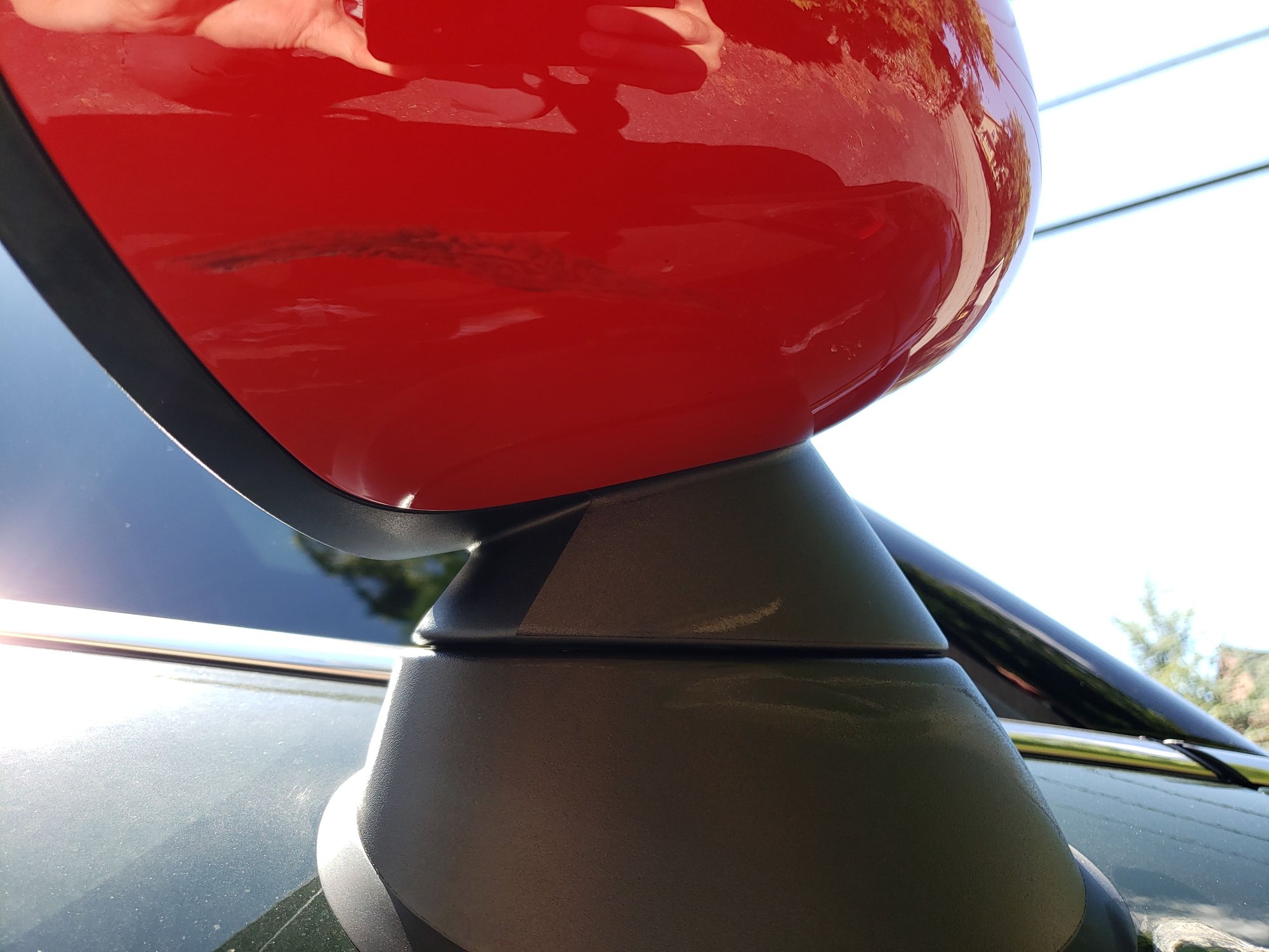

Damage to the cap and to the rotating assembly (still works though).

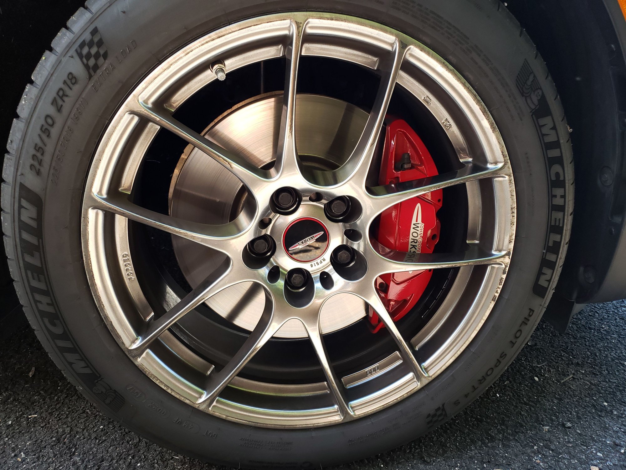

Hard to see, but my new wheels with only 400 miles on them pulled paint and rubber off the offending car.

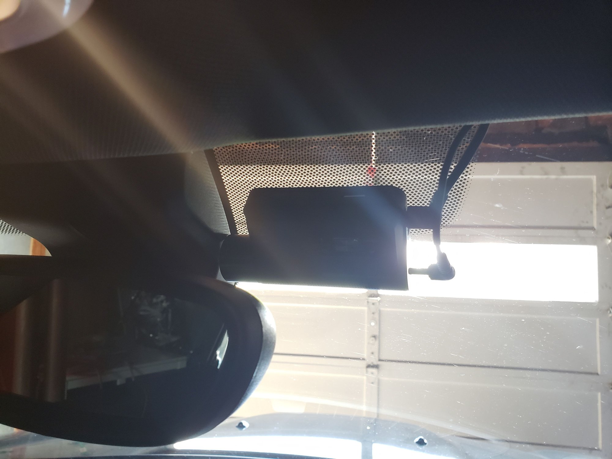

I hardwired everything and hid the wiring as much as I could. Hopefully, this helps anyone get the idea of how to set things up. I probably should have documented the whole thing as I was doing it, but you know how it goes when you're in the zone and just trying to get it done.
Here's the front cam mounted to the right of the rearview mirror. The wires are hidden under the headliner, and go down the A-pillar.

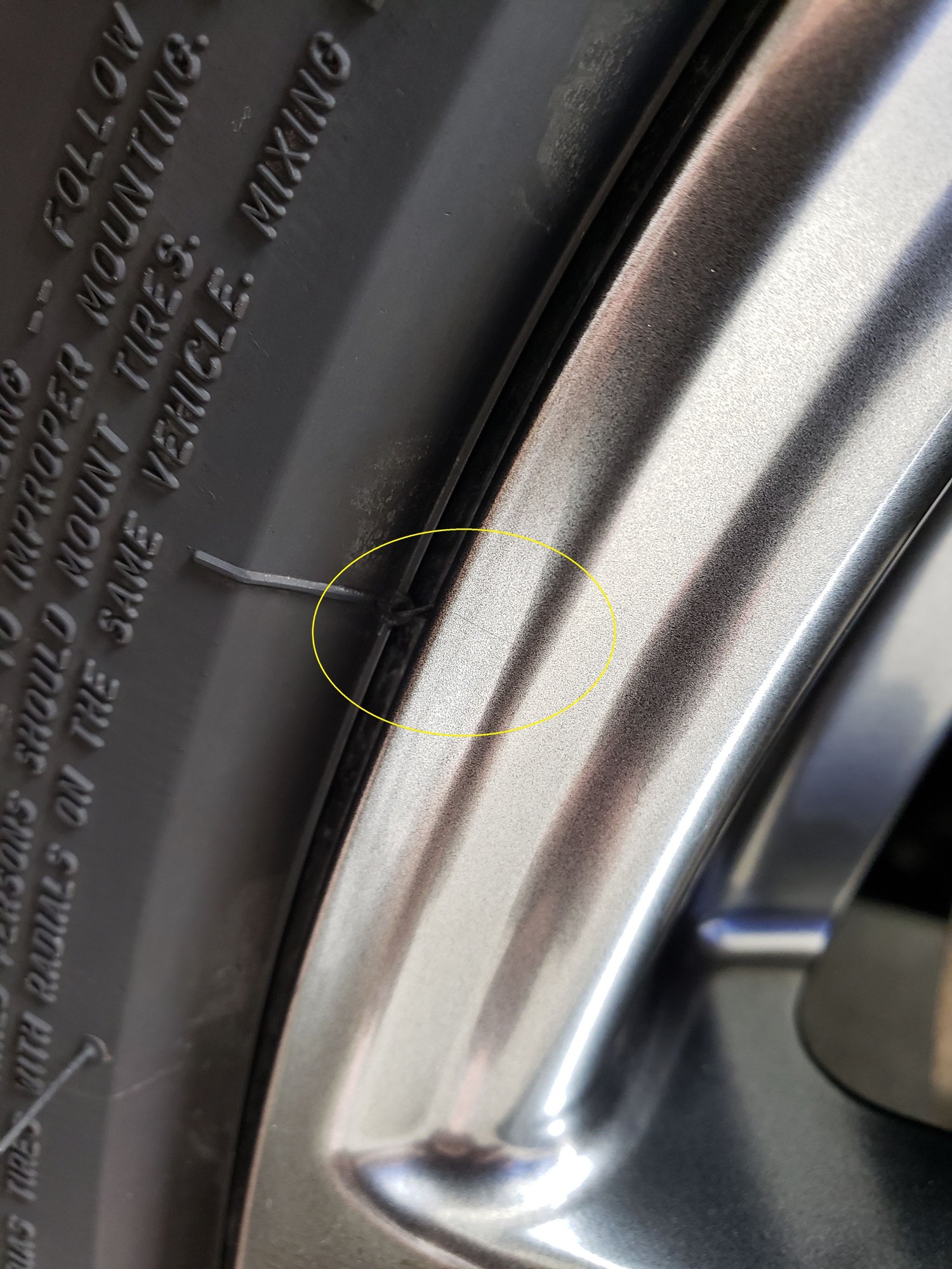

possible crack in my wheels/rims
I thought I'd start looking at the extent of the damage on the rims, so I rubbed off some of the rubber/paint from a section of the front wheel where I got swiped. It looks like I *might* have a hair-line crack. Does anyone have experience with this type of damage? I'll definitely point it out during the damage inspection. I'm not sure my insurance will cover my aftermarket wheels.
You can see a hair-line mark in the yellow circle
Running my fingernail over this line feels like there's definitely at least a scratch.

if you are going after someone else’s insurance you can and should claim EVERYTHING that was damaged.
Your comprehensive policy may exclude such things if you claim against your own. That exclusion doesn’t apply to other people when you make a claim against them. Their insurance company will be delighted if you don’t claim all your damages though
that said, from the photo that looks like a scratch, not a crack. But ask a mechanic with some experience with wheels for their evaluation. Us people on the internet are notoriously unreliable
I'm hoping it's just a scratch...time will tell.
