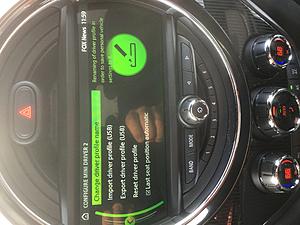

We enable in the profile and works perfect. I unlock with my key it adjusts to me she unlocks with hers it moves to hers. Also sets the mirrors and radio etc, all the way down to I have lines on the backup camera and she does not.
Old Oct 3, 2017 | 10:00 AM
MIminiclubman's Avatar
MIminiclubman
Joined: Feb 2009
Posts: 810
Likes: 63
From: South Central Pennsylvania
You have to click on the driver profile. You cliclk the driver prfile and it is selection button at the bottom.

Finally figured that out late last night. Thank for everyone's input!
