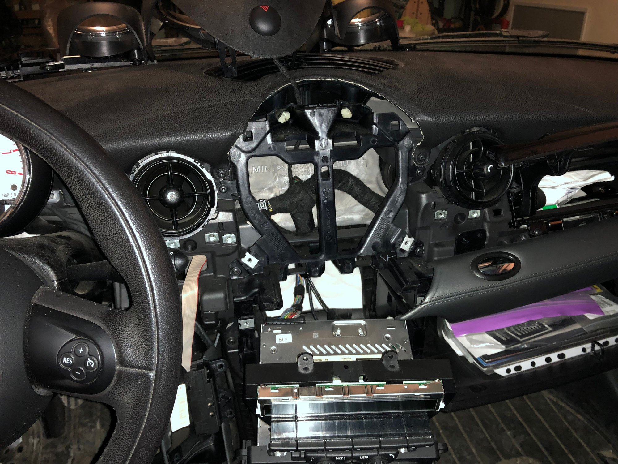

The trickiest part is to know where the screws and retaining clips are. Once you know - it's pretty easy. Back in the days when I was working on custom CarPlay solution I used to remove majority of dash trim panels (see pic below) and put it back in less than 10 minutes. Very first disassembly took much longer of course
Plus you better do these kinds of jobs when it is warm enough. Ol' England now is not and in my experience that makes the trims much more prone to cracking (next nightmare )
I had in mind to add an MMI box to my MCS for having Carplay. I might combine the two things and make this titanic disassembly more digestible.
For some reason I have no problem digging in the engine bay....but when it comes to the interiors, knowing those damn plastics, I am always very wary.

The picture was taken in February 2019. I was working in my garage in Toronto which has no heating. Of course I’d prefer to do it in warmer weather and on my driveway, but just couldn’t wait. Plastic panels were fine. I believe it has to be way colder for them to become brittle. The key thing that finally made me brave enough to start the dismantle was a detailed online video on how to do it on my model, so I strongly suggest finding one as it’s going to save you tons of time and let you steer clear from mistakes that can lead to clips or panel breaking.
And if you have another project in mind that involves dash disassembly it makes total sense to do it the same time. Spring is coming soon
