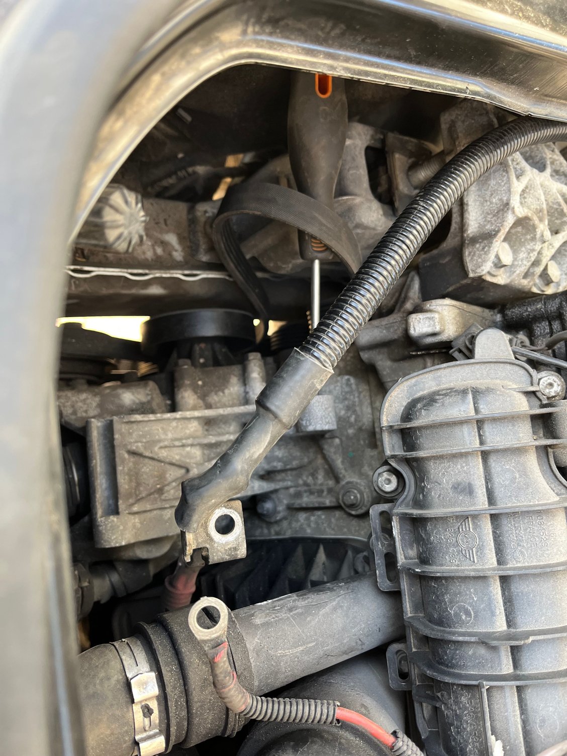

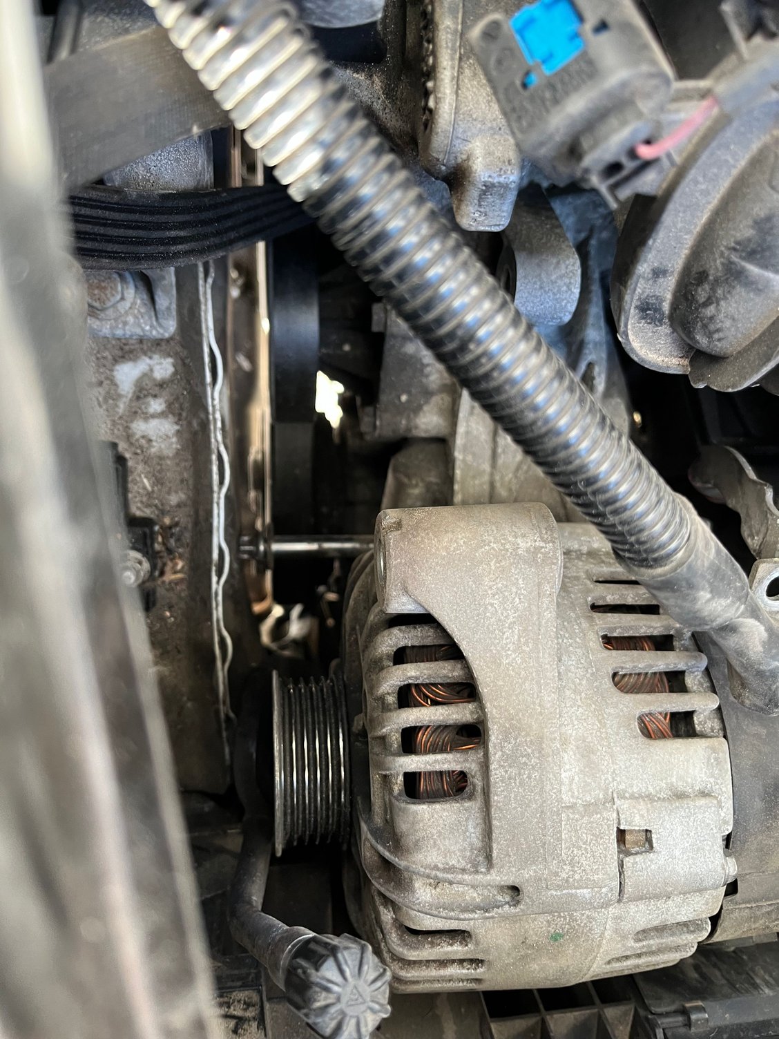

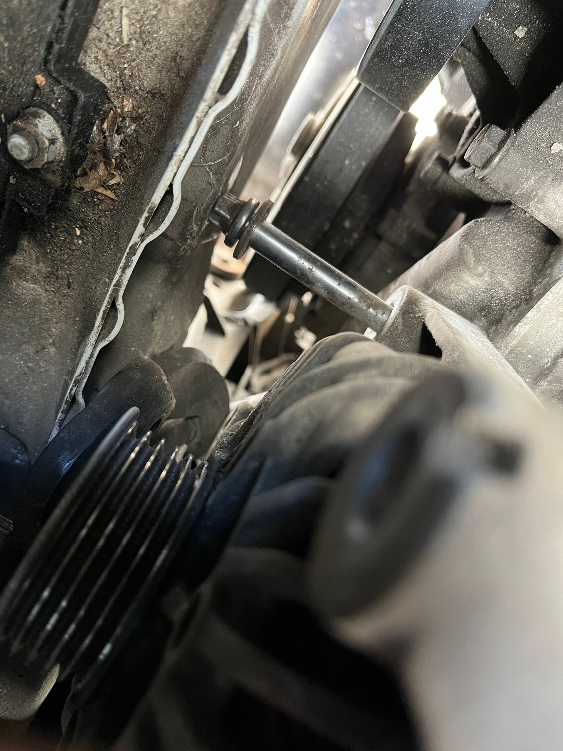

Hey forum, im having a problem with replacing an alternator, car displayed red battery for low voltage, checked the alternator belt, it’s fine, must be the alternator itself, loosened the belt, got the upper bolt loose and out, spun the alternator a bit back for more access turns out lower alternator bolt isn’t getting out because of the frame picture attached, tried loosening the engine mounts to jack up the motor a little - didn’t budge. Any help is appreciated thanks.

nvm i’m just a bit retarded, had to jack up oil pan a bit, with block of wood - to not damage the pan itself, to relieve pressure from nut (18mm) that was holding the engine mount, now we gucci
