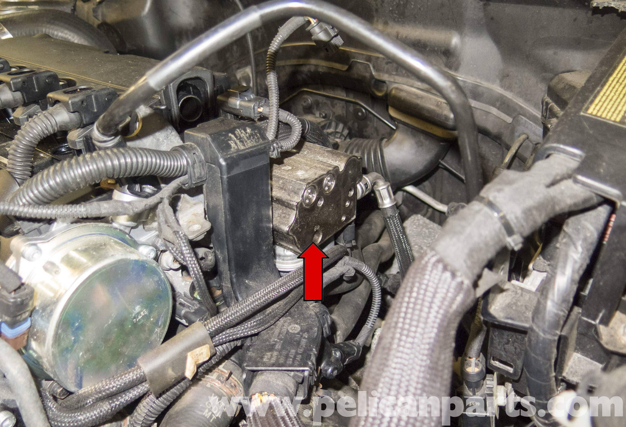

Yes, March 2012 was the change-over date for the high pressure fuel pump. If you do indeed have the older style fuel pump, my suggestion would be to see if the dealer will check it out for you. I believe due to the issue, the warranty was extended to 10 years / 100k miles, whichever comes first. You're almost there if that the original pump!
Pop the hood, and look at the right side of the engine, on the side of the head. The older fuel pump can be seen in this picture:

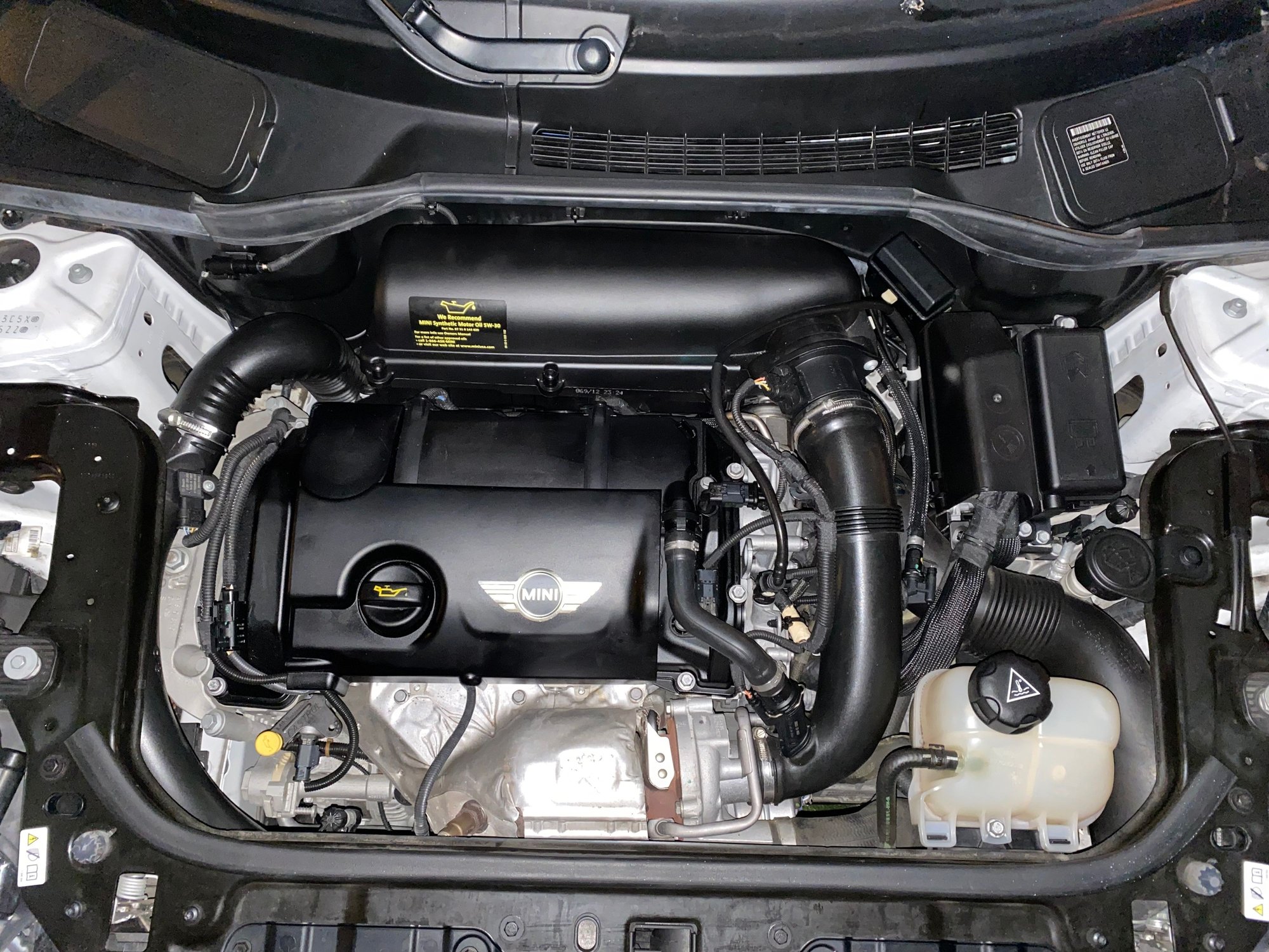

My motor doesn’t look like yours

It’s not mine, but a picture from the interwebs.
Based on your picture, looks like your engine has the later style high pressure pump… When were the plugs last changed?
