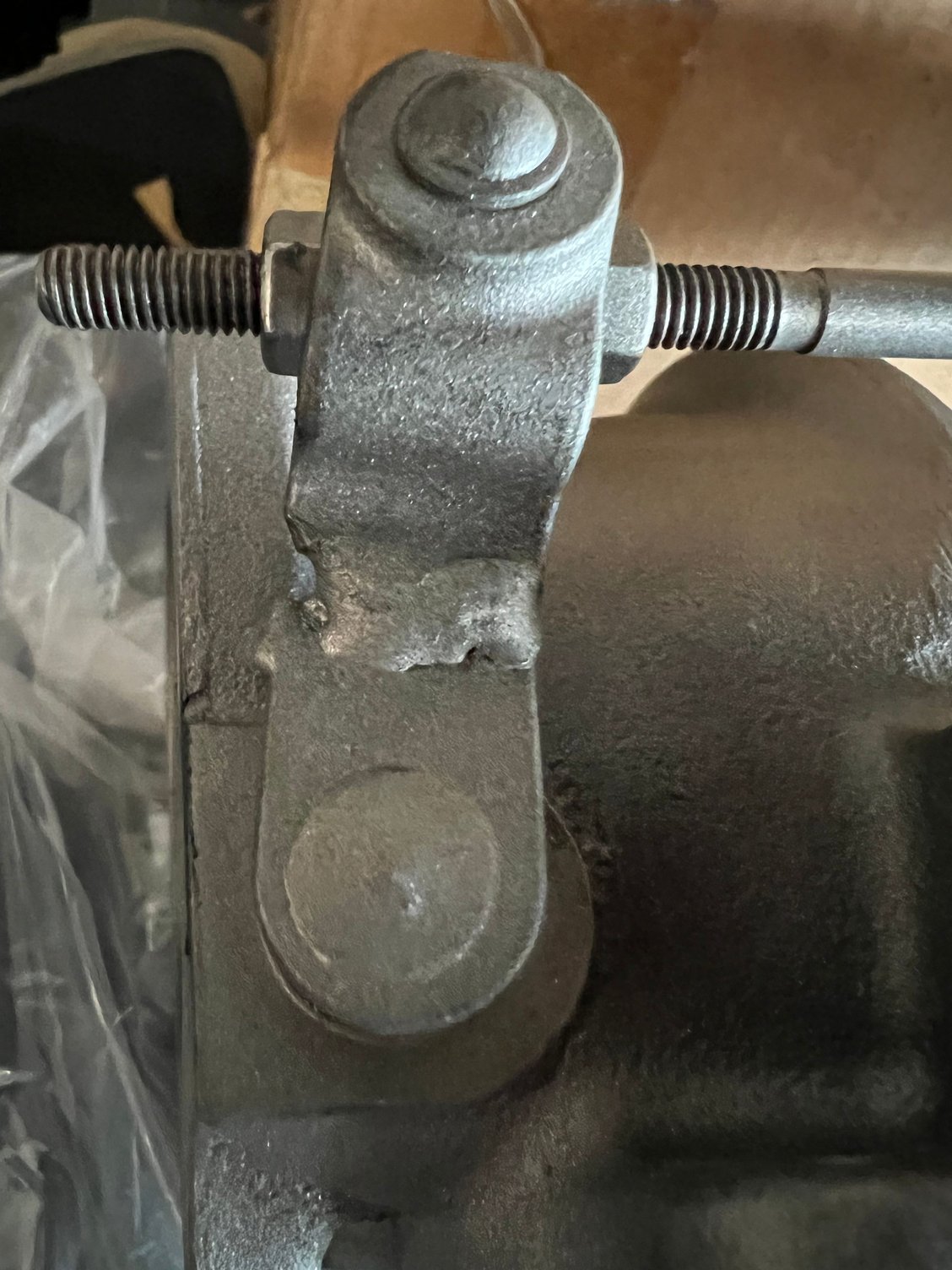

Update the turbo I bought was inspected by the mechanic today and is deemed not usable.
Purchased from outmotoring.com a "JMTC K03 Turbo: 40mm: Refurbished" shipped directly from JMTC.
Mechanic's comments and photos:
"....found that the wastegate linkage has been previously broken off and welded on, crooked, and not a very good quality repair. Also, the wastegate flap inside the turbo is not adjusted correctly. I've attached pics to compare. Both of these can cause issues, the welded piece can be broken off and cause the wastegate to stay shut causing the car to over boost and possibly cause engine damage.
The wastegate being out of adjustment will cause tuning issues due to it not opening and closing like a factory."
Ordered a brand new JCW Borg Warner turbo from ECSTuning.
My experience with JMTC is to avoid them, before this issue was found their shipping was poor, included metal gaskets arrived bent they did not offer to replace them when contacted.

Ugh, JMTC needs to be boycotted… That waste gate arm looks terrible! Thanks for the update
