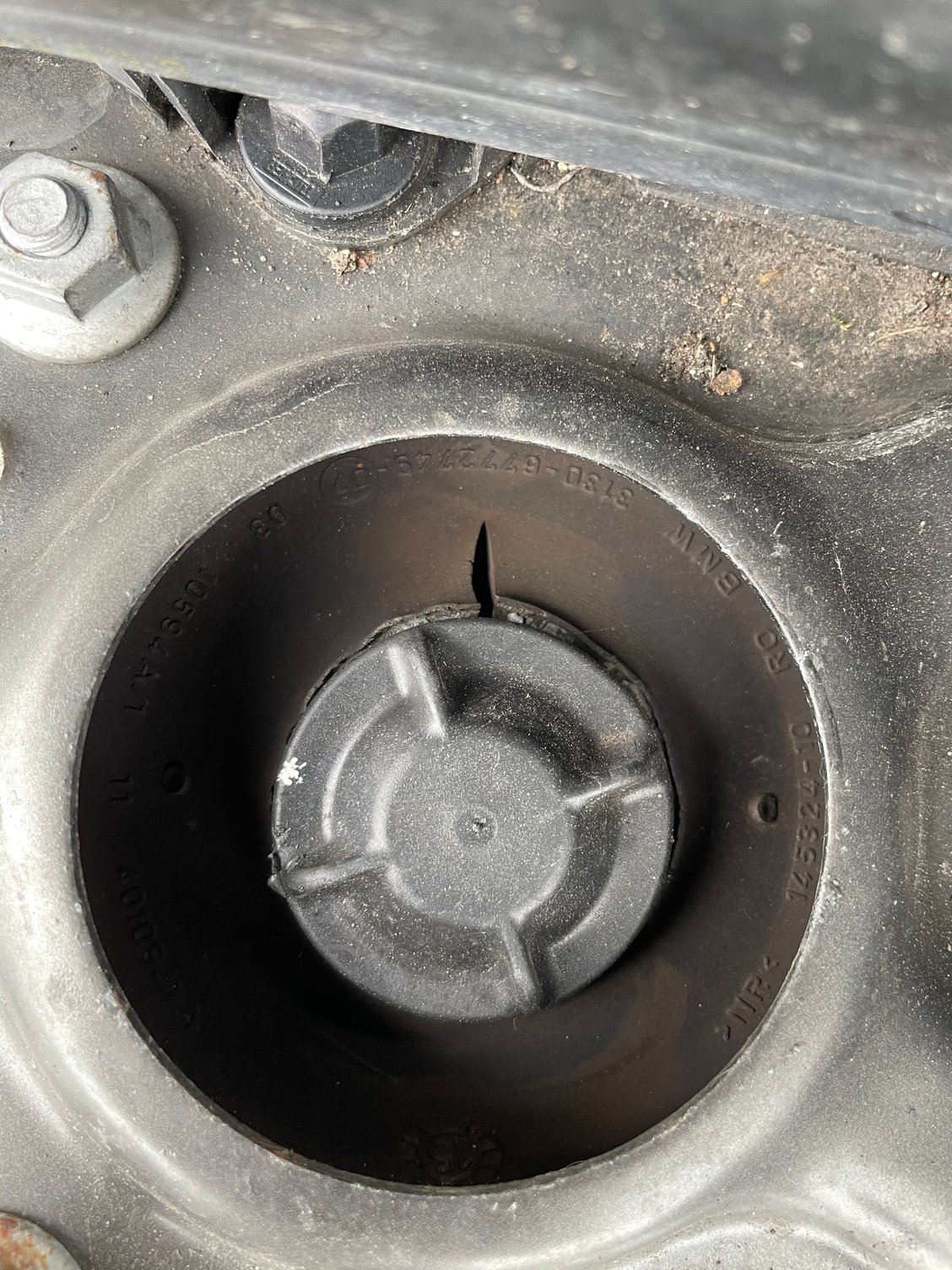

And do I need to replace my top strut mounts Both got small splits in the rubber. ?

Yup, you need new front strut mounts. I would also consider getting the PowerFlex rear upper shock mount bushings.
