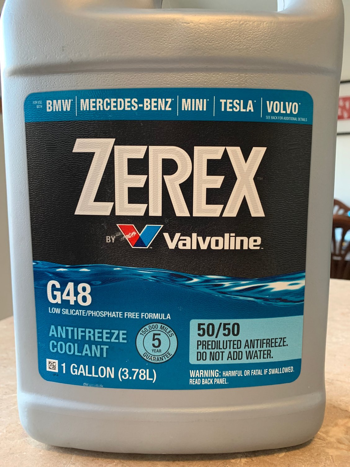

For coolant, I use Zerex Z48. Easier to find than the BMW coolant since we don't have a local Mini or BMW dealer. Seems to me that I researched it before choosing and it meets the relevant specs.
I think you mean Zerex G48, which is bmw/mini specific.
Old Jul 9, 2020 | 04:52 AM
Jason Cornelius's Avatar
Jason Cornelius
Joined: Dec 2019
Posts: 2,107
Likes: 691
From: Cincinnati, OH
This is the one I picked up and used for coolant swap
