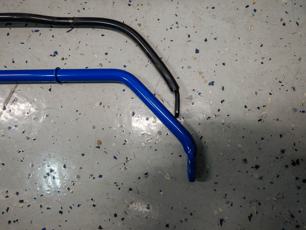

On the swaybar I went with the NM Engineering 22mm rear sway bar (PN/ NM.258860). I went that route because I liked the fact that it was a solid bar with forged ends. I prefer the feel of the solid bars vs the hollow. The adjustability was a plus and the billet mounting brackets with the grease fittings closed the deal. A VERY nice swaybar. The bar is a quality piece with a very good finish on it. When I installed it I set it to the middle setting of three. After driving for a few weeks, I cant say enough about the bar. The change in the roll, or the lack of it, is HUGE. It is really a night and day difference. The car is far more stable in turn and the sway bar does not add any adverse reaction back. In other words, the Countryman does not sway back and forth at all coming out of a hard or sudden change/turn. The billet bushing brackets are top notch and they are greasable, so top marks there as well.
A pari of shots to show you the differences between the stock and NM Engineering bar and the bracket hardware.
