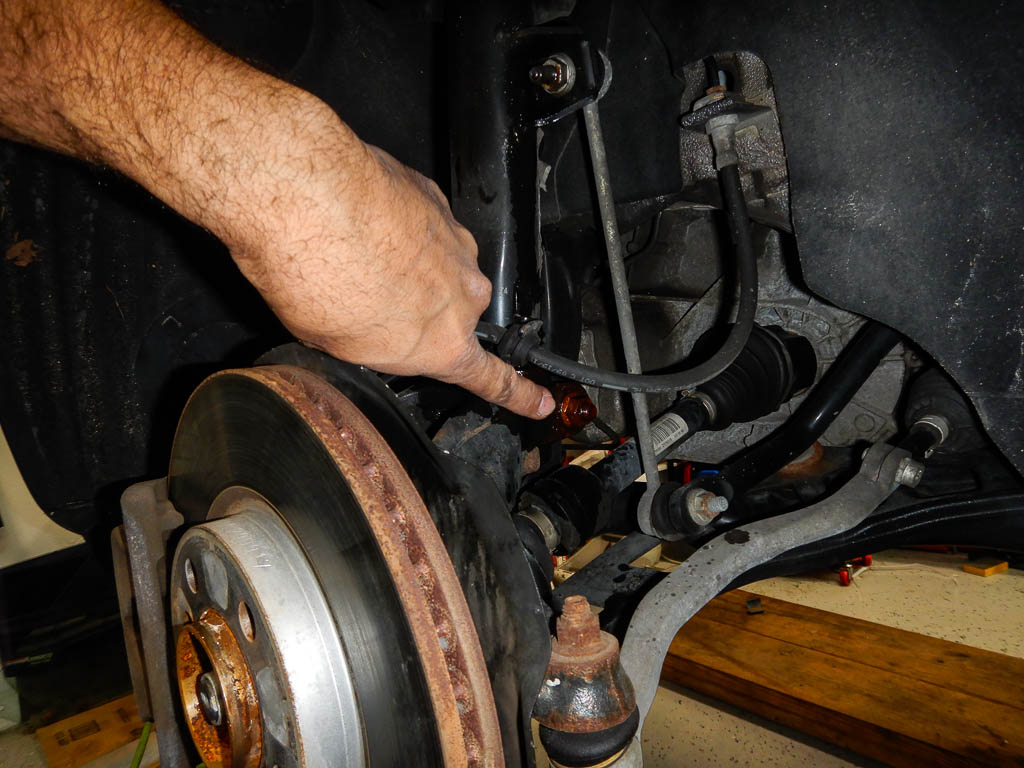

Remove the wheels and grab the WD40 and hit all the nuts you'll be removing (I'll show you those as we move on the front and rear) and, VERY IMPORTANT, hit the front strut bodies where they insert into the front knckles. These are in there and tight. Likely corroded to a certain extent and stuck in there. Letting that WD40 penetrate will be VERY HELPFUL.
The sway bar link bolt.

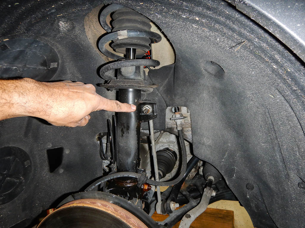

The strut collar bolt.

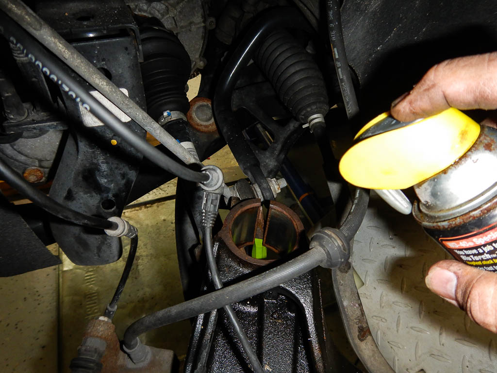

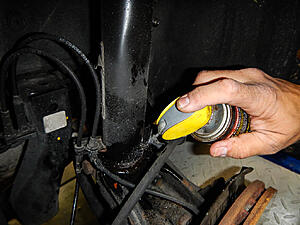

The WD40 spray of the strut.
Now that you have sprayed everything. Go back and hit them all again. (TRUST ME). Then remove the lines and sensors attached to the struts up front. They are all very obvious and on rubber grommets simply pushed into place. Pull them out gently and move them aside a bit.

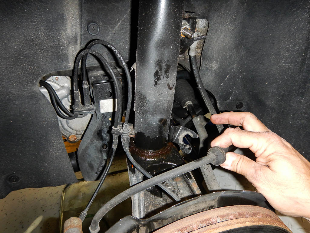

Spray the strut body again with WD40. (Yes...I've said it before but when you go to pull them you'll be glad I did)

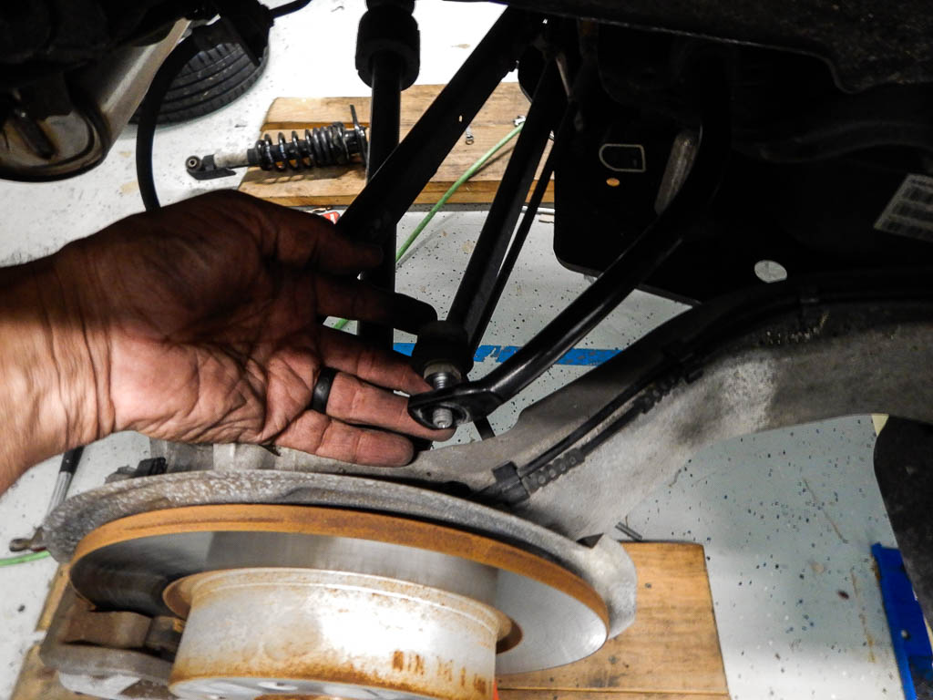

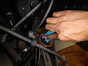

Now you take out the sway bar link. You will need the torx (T30) head in the bolt and a wrench on the nut. This stops the bolt from spinning as you loosen the nut. I have the hex ended Torx but a regular driver is fine. Whatever you have/can get. You can spin the bolt or nut. My only suggestion is do this by hand. Using a power driver of some sort can damage the ball end of the link if spun too fast.
Remove the strut collar bolt on the hub carrier/knuckle.
Click image for larger version
The struts up front are in a collar. The body of the strut has likely corroded a bit and fused to the collar a bit. Removing the strut is not easy and will require some "persuation". What I found to be easiest was to spread the collar a bit with something pushed between the tabs on the collar. I used a heavy chisel and tapped it in there. The the photo below.
You do not need to spread the tabs much. Just enough to free the collar a bit. On the passenger side I had to tap the knuckle a bit to break the strut free. In the photo you'll see the corrosion on the strut body about 2 inches above the collar I was tapping with the hammer. This is why I left the bolts on top loose. It allows me to tap the strut out while holding the upper end.
I will take some effort, twisting, tapping, pulling on the suspension arm ect. to get that strut out of there. It will eventually come loose. Once out of the collar, remove the upper bolts carefully and remove the strut from the car.

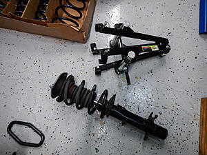

The strut out of the car with the single arm spring compressor next to it.

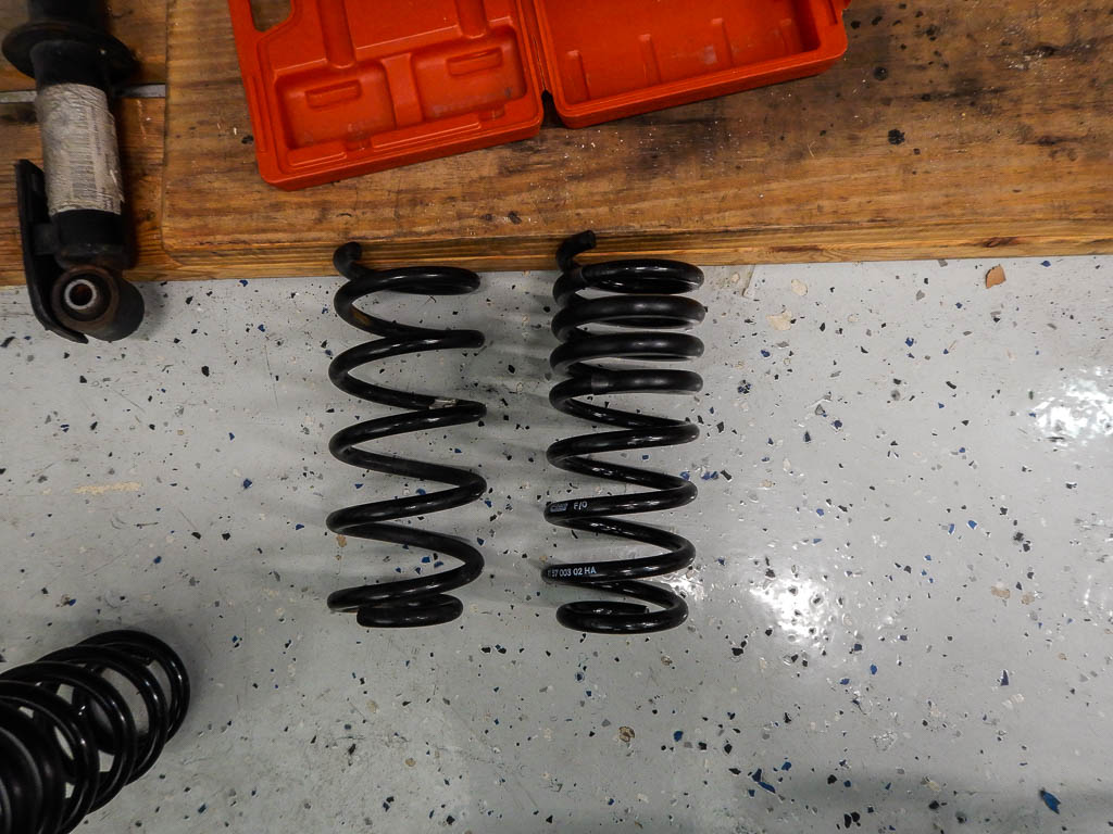

Remove the spring and then slowly remove the compressor on the stock spring.
Here are the two springs compared for the rear side.

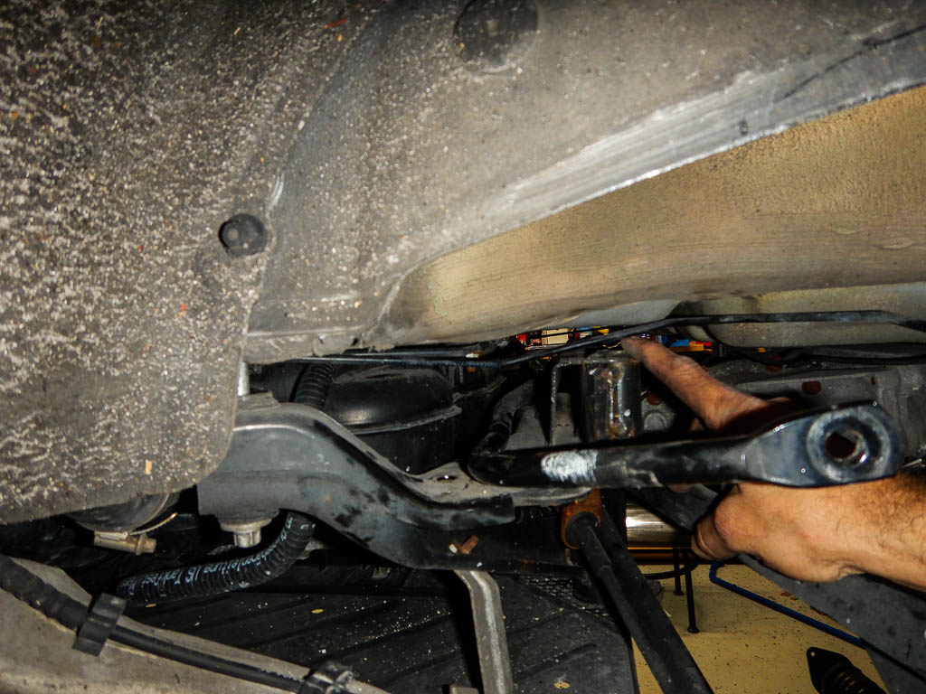

You remove the sway bar links at each suspension arm. In the rear they are not attached to the shock/strut but rather the suspension arm itself.

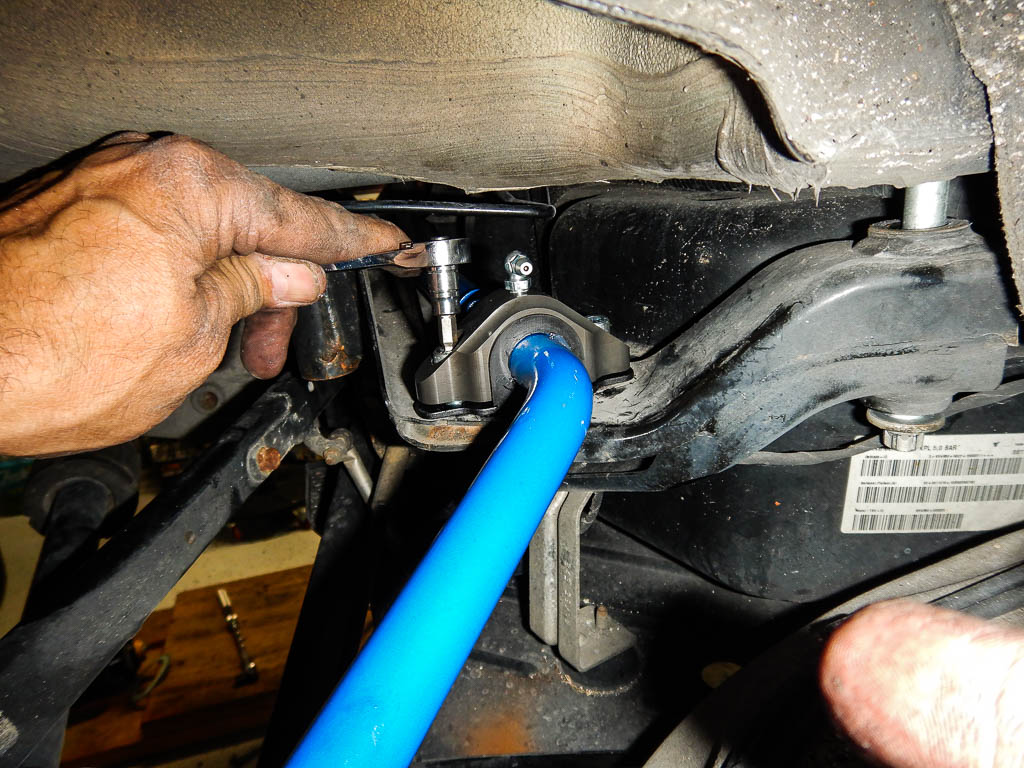

Once I was done gawking at the new bar, I slid the new one into place. I kept the plastic on it to protect it from scratches as it was installed.
Once in, take the plastic off and put in the bushings with the supplied grease in there. Tighten the new collar to spec.
Not going to lie, those mounts are real nice. The grease fittings are awesome to throw some grease in as time passes.
Once those are all tightened down, I reattach the rear sub-frame and tighten it all to spec.
The sway bar is adjustable. I simply put it into the middle setting by attaching the links in the designated holes/locations.
