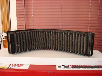

btw, when doing your oil oil and filters I'm sure you are checking the engine air filter but don't forget the cabin air filter as well .... attached pic is what my first cabin filter check yielded - something the dealer was supposedly checking during pre-paid maint'

Whoa! Good idea, need to check that filter TODAY!
I'm still in search for a list of items that need to be gone over at periodic intervals; diff fluid, cabin air filter, engine air filter, etc.
