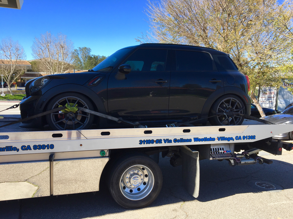

Too much power (Manic stage 3 and bigger turbo) for the stock CMS ALL4 clutch. Lasted 18K. Adding a stage 4 clutch this week. The tow truck driver did a great job getting my lowered CM on with out scratching. Now I'm forced to drive the GTR

Hit me up when you want to talk. I haven't found a AWD dyno near me yet. 18K is low but Mini shouldn't have used the same clutch they use in a 2wd, 600lb lighter car

Uh no, sorry to hear that. I wonder if one of the upgraded clutch kits from the R56 would fit the Countryman like OS giken and Clutch masters?
All N18 R56 clutches will fit the 2wd or 4wd Countryman
