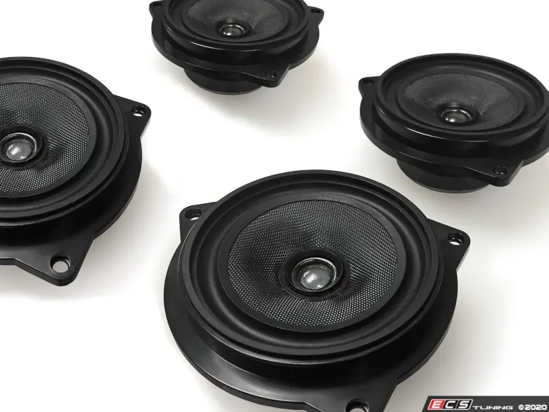

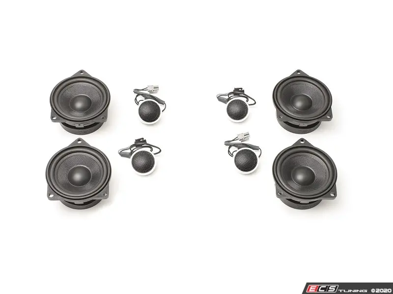

The other option we have is Bavsound, they have H/K upgrades and NON H/K upgrades for the speakers, direct swap.
https://www.ecstuning.com/b-bavsound...er_countryman/
They also have the upgrades subs under the seats for H/K and Non H/K cars.
