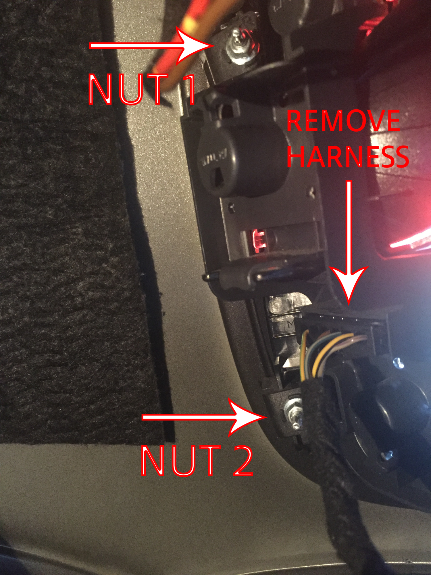

SERIOUSLY! DO NOT USE A SCREWDRIVER TO POP THEM OFF!
I just did mine the other weekend and all it takes is a 1/4 ratchet, a short extension and the right size socket (can't remember if its 7mm or 8mm, somewhere around there), and honestly, about 15 minutes top!
Once you get them out you'll quickly realize why using a screwdriver would not work that well. The tension between each clip is enough that you really need to take the whole housing out. It's really not that difficult.
I tried plastidipping mine a couple of times and I just got fed up with not being able to apply it correctly and evenly. Then I met a buddy who works in the parts department at my nearest MINI dealership and he hooked me up with the actual trim rings.
Plus I feel you would get better results with actually taking them off. Hope this helps. I know there is a thread in here somewhere on how to take them off...can't find though.

Hey man! Shooting straight with you here, it really is a lot easier then you may think. I had the same mindset when I went into doing it. I was thinking it was going to be a lot more difficult. I was worried I was going to have a hard time pulling it apart and putting it back together, but I was extremely surprised as to how easy it was.
Scratch the extension, I just used a deep socket on a 1/4in ratchet.
When you pull the grill out on the inside, just look inside and you'll see the two bolts/brackets. Pop your ratchet in and have at it. I also unplugged the wiring harness before I pulled the brackets off.
Take your time with the rings. The amount of tension on the clips is pretty decent and will require you to lift one and pull it up and hold it while you do the same to the next and so on until it comes off.
I'll check back in tomorrow to see how you're doing. If you need me to post a few pics I'll do it, but you'll be fine! :thumbs:
EDIT:
Ran out to grab this pic for you. The deep socket is absolutely necessary to remove the two nuts as the bolt side is attached to the light housing itself. You need the deep socket so you can get down far enough to remove the nut. I hope this helps.

frank!!
Thanks for the pic, man!
Totally helps! I'm on the road right now so I can't get to work on my car, but I wanted to say thanks for taking that pic and showing me exactly where to work!
