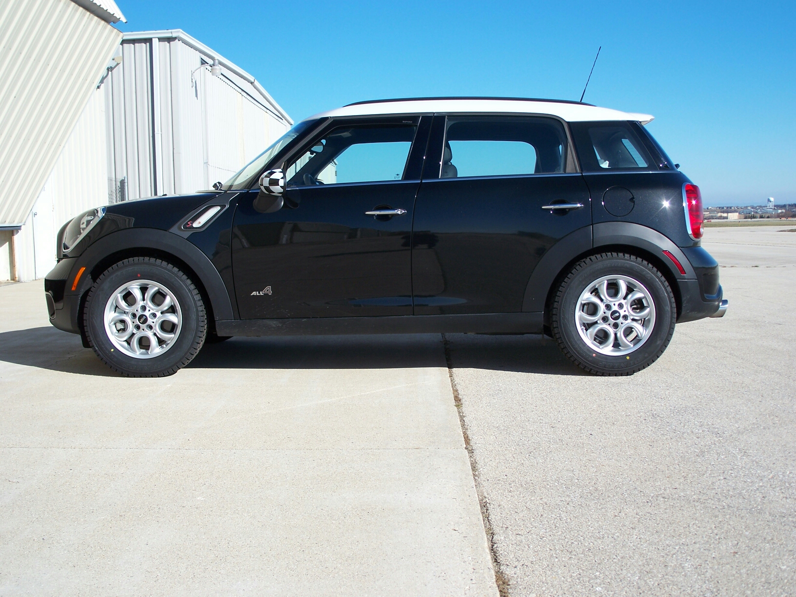

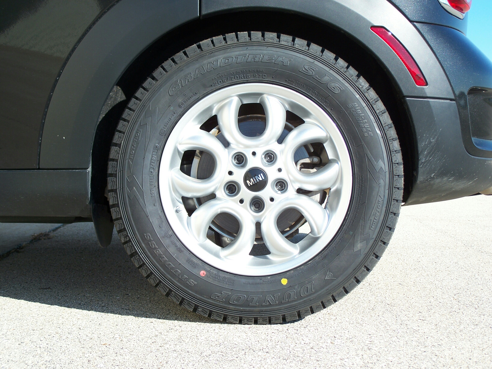

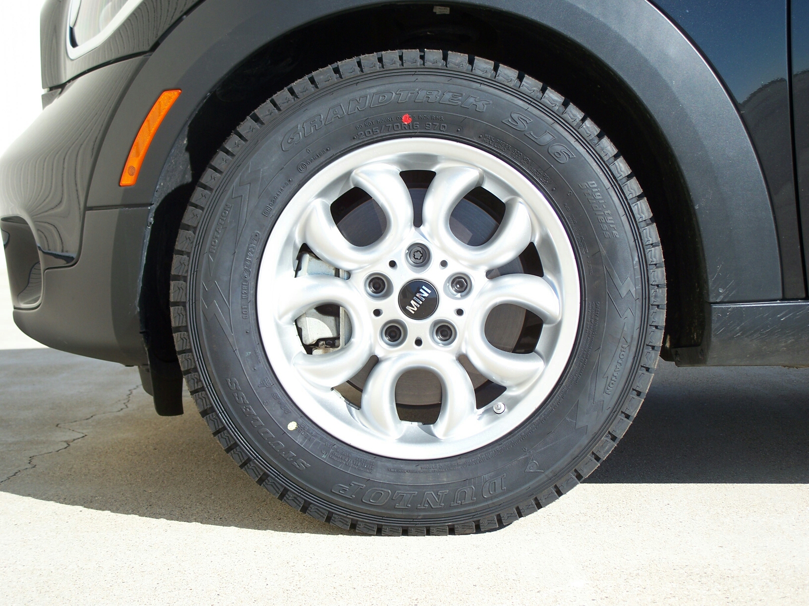

i run 205/70R16 Dunlop grandtrek sj6 AT winters on mini oem alloys, 16x6.5 et 46
they also are 27.3 inch OD
also tried 215/70R16 and 205/75R16 but they both rubbed on compression and the fronts rubbed at full steering lock
i have no rubbing at all with this setup and i have the sport suspension, 1 cm lower than the stock suspension ... loaded the car with 6 200+ pound guys, 2 sitting on the boot lip, suspension sitting down on the bump stops
i wanted the tallest possible sidewall for wheel protection from chicago potholes, do far so good ... on the 4th winter with no dinged wheels
a side bonus of the 16 inch tires is price ... $83 each
