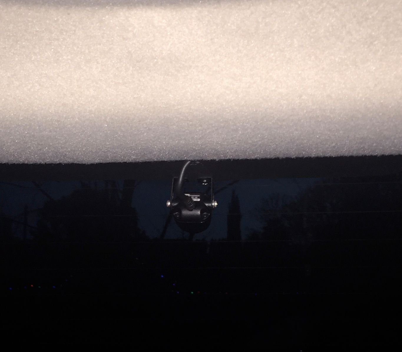

Here's my mounting solution.
BTW its for sale in the classifieds, went another way.
