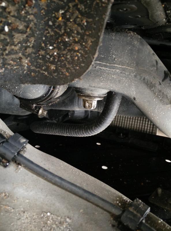

I do like the sway - Way's 22mm. Yes, installed myself. I remembered reading some install threads specific to the All4 quite awhile back, but couldn't find them when it came time to install on the CM. So a couple of notes from the install, some duplicative with any other RSB install on a 2nd Gen MINI:
- removing the shocks/springs is helpful
- brace under the rear diff...jack is best, that way you can lower it a bit as you need more clearance from the rear sub-frame to the body
- of the 4 bolts holding in the sub-frame, I think I removed 3 of them. Loosened the 4th but didn't completely remove it. Needed a little bit of prying to get enough clearance to remove the old bar and when putting in the new bar.
Straightforward install.

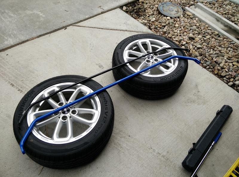

Sprint Booster and NM Eng RSB on the way!
MINI is taking shape!
Hopefully I can get that bar in this weekend and then the fun really begins!

M7 - I am still looking into the strut, putting on the 22mm RSB this weekend, so I'll start with that for the time being.
I know people rave about putting strut bars on MacPherson suspension setups!

SWAY BAR IN!
Incredible changes in handling, much more composed now!
Couple of install notes, the 2015 CM subframe bolts are torx bolts not the 16mm variety. A 11mm Socket works nicely on top of the bolt.
Also, just back out the front subframe bolts until you can slide the rear bar over the rear lop of the subframe, and then just pull it out.
Ton of fun!
