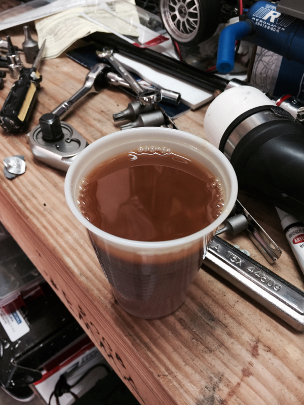

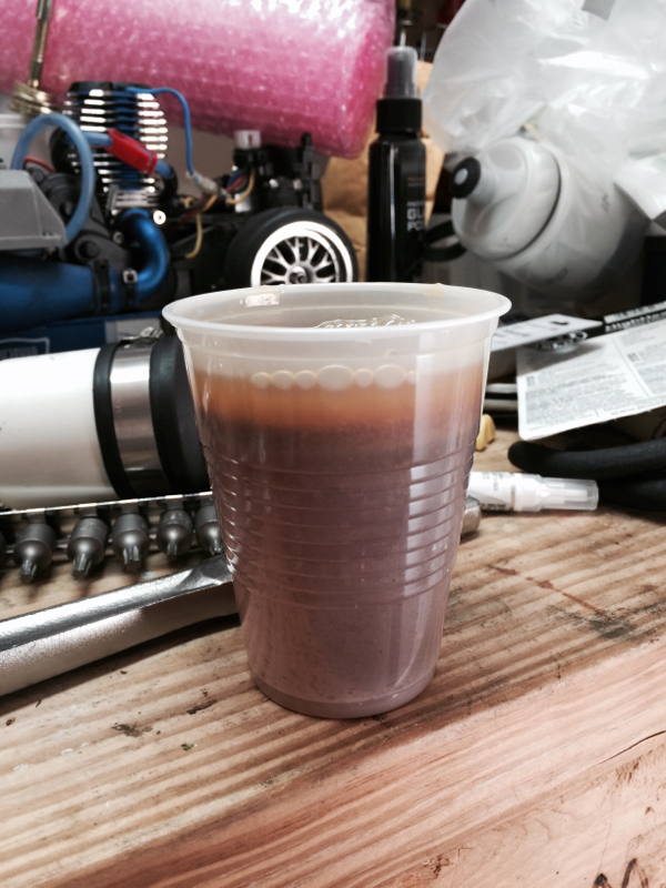

N18 Oil Catch Can
Or those of you that don't think the N18 benefits from an oil catch can... About 10k since I installed.
Attachment 106366

What are we looking at? I get what the catch can does but that appears to be alot of condensated water vapor as opposed to "oil". In looking at what you collected over 10,000 miles it does not appear to be alot of"oil".
Dont get me wrong. I thank u for posting. But i dont think you have the unicorn that u may think u have to share
Thoughts?

Maybe it's me but I would prefer to not have this dumped back in the engine.

I had the same catch can installed for about 7,000 miles and when I went to empty it, it had 3/4 full of mainly fuel, with a bit of oil mixed with it.

Try two catch cans and see what you get there is a Mann pro-vent that has its own regulator. Or maybe Siamitchi they have a proper mesh setup still none of this should be getting to the engine at all, and the valve cover controls are just not up to the task I currently run two catch cans and a final fine mesh element and its still not enough my next set up will get it though. I would straight pipe but the vacuum on the crank case does help the way the engine seals and runs, and on a street car I just cant justify extra emissions. An adjustable and variable vacuum regulator would be nice. Water vapor should be collecting a bit more especial when its cold I would check it more often possibly. Warranties are nice but not bullet proof better to take care of this and filter what you can just take it out when you go to the dealer.
