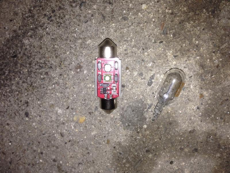

Trying to install LED license plate lights. Seems like I have the wrong bulbs, but all the sites show the same pics. Here's a pic of the oem bulb next to the new LED. The shapes on the end are different and I can't see how they'd fit. Any help is appreciated.

OutMotoring? I had the same issue with my Clubman.
The rear bulbs I have are a 5w5 (194) bulb. You can get LEDs for them, I had some but the flickered and looked shabby (but did not set off the CAN warning.. I did get CANBUS bulbs).

Were they a normal wedge bulb? The ones I received have weird silver ends
Those are for BMW, I had them on my X5 before

Here's where I got mine: http://store.ijdmtoy.com . You need W5W (do not get T10 as they are too large) that are error-free otherwise you'll get a " light-out" code.

figured out a lot of the sites have the wrong bulbs in their 'bulb finder'. The bulb needed is a 194 wedge..got two at autozone
