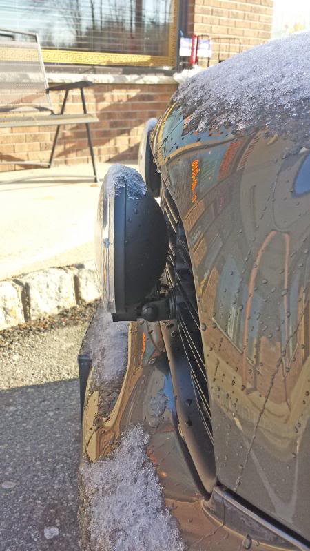

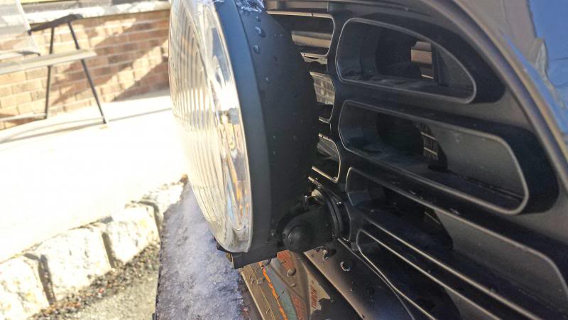

Old Apr 16, 2014 | 06:43 AM
n2000snake's Avatar
n2000snake
Joined: Feb 2014
Posts: 48
this is what it looks like mounted.. with a longer bolt big washer and nut

Did you use any type of rubber washer or bushing between the large washers and the grille? I'd be a little afraid of damage from vibration and rubbing (especially since mine is a non-S with the silver grille).
Old Apr 16, 2014 | 08:34 AM
n2000snake's Avatar
n2000snake
Joined: Feb 2014
Posts: 48
yes i got a rubber seal from home depot,, i ordered another seat, i think iam am going to 4 lights

wow, that mikey has a hair stuck somewhere... When something says brackets, you look for actual mounting hardware brackets, not a swivel with a bolt already attached to the lights... Now that new pics were posted of the actual mounting, we can clearly see how it was done and what is needed... Thanks snake for the pics
