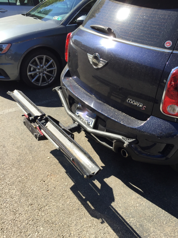

The thing to be concerned about is not the total weight of the bikes on the rack, but rather the leverage that's being put on the hitch by a 3-4' lever arm with that weight on it. If you work this out you'll be way over a 200lb tounge weight.

exactly my concerned. the total of my set up (3bikes + rack) is about 150lbs. but the rack is sticking out 3ft from the hitch. I'm pretty sure the weight will be more than 150lbs because of the leverage. I don't know how to calculate though, anybody can here can show me how?
