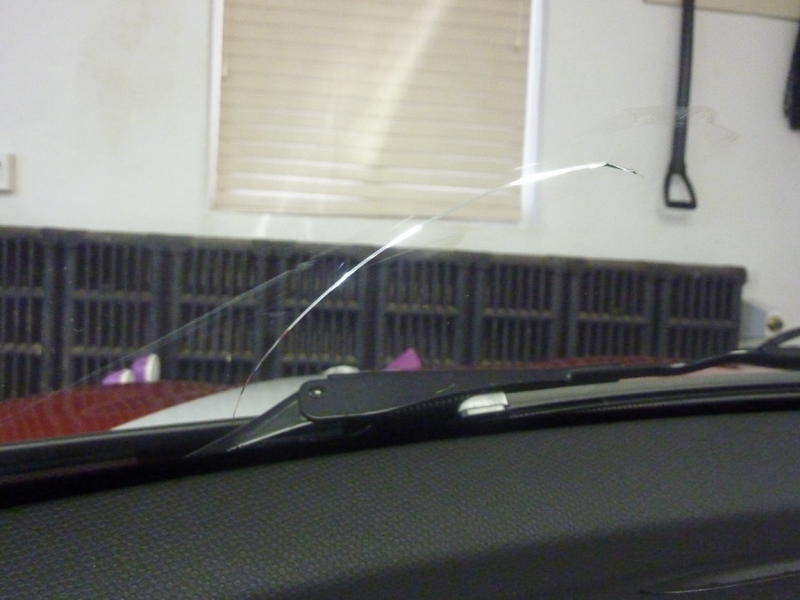

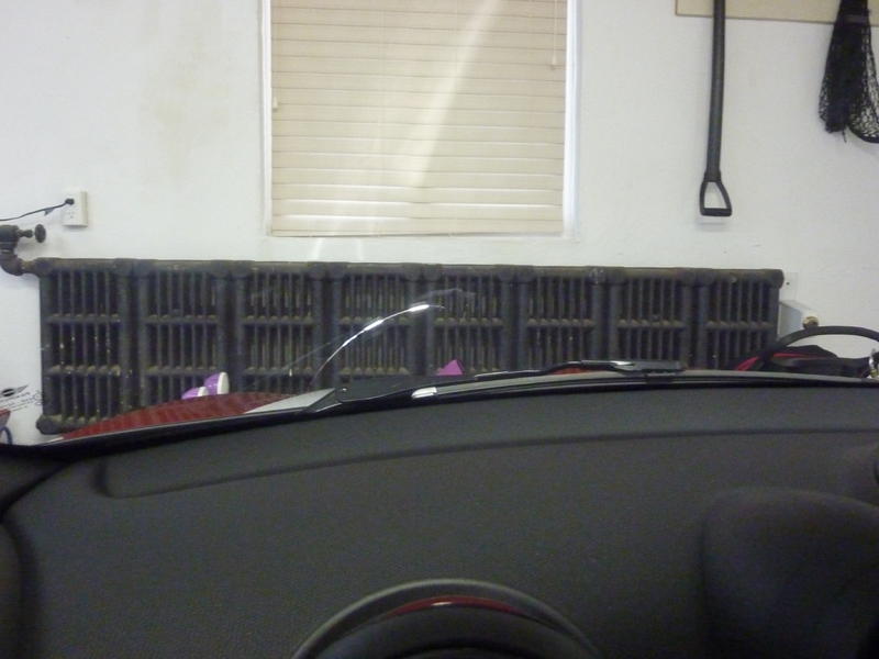

In less than one week and 100 miles driven, my brand new 2014 Mini Countryman developed a crack in the bottom driver's side corner of the windshield. There was no noticeable impact damage to the glass. Admittedly, the crack may have been precipitated by a stone, but since I noticed no impact (the crack is right in front of the driver's seat), I have to believe that a design issue is at least partly to blame and that this would not have occurred in another vehicle.

Cracks on new glass come from one of two issues or combo. If it has an edge defect on the glass that can run after install. The second is binding on install, meaning install was not done with even compression by robot. Combo is install is off a little putting extra preasure so even a small defect runs. Is it the inside or outside sheet of glass that cracked? There is a vinyl layer separating glass sheets, road damage is always outside. If inside sheet is cracked it was bad robot scenario.
Windshield of CM has little slope. Windshields with more slope see less energy transferred to glass since fine particles or rocks deflect taking energy with them. Less attack angle means higher energy transfer with even fine particles pitting the glass. They actually use the angle of the windshield in the stocking algorithms for stocking aftermarket glass. I had a hummer for a while, what a bummer :-). Windshield was either cracked or pitted all of the time.

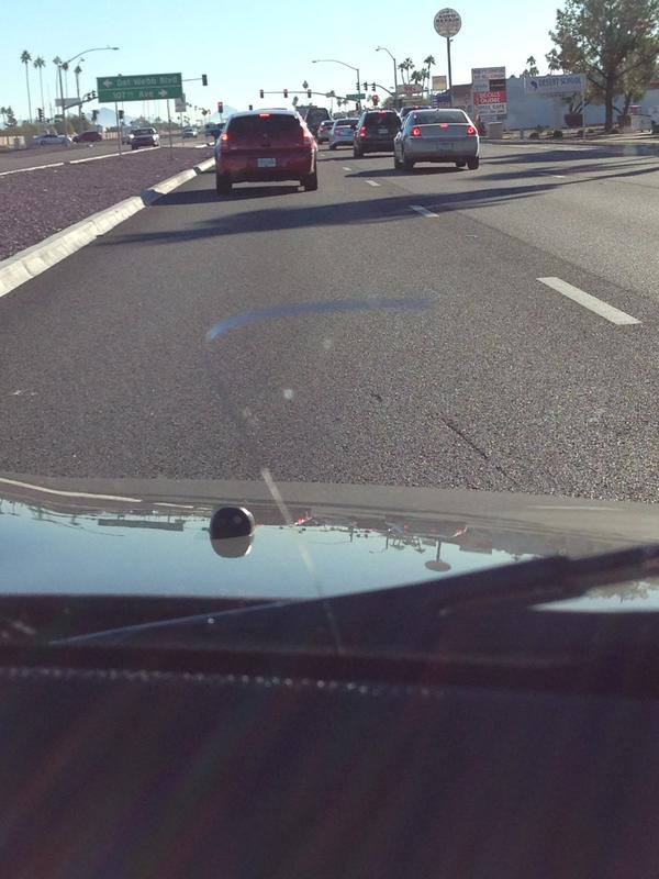

Oddly enough I noticed a crack in the windshield of the dealer Paceman loaner I used for a few hours. No chip on the outside or any other noticeable impact. Attached is a photo with the crack. Only 4,000 miles on it.
