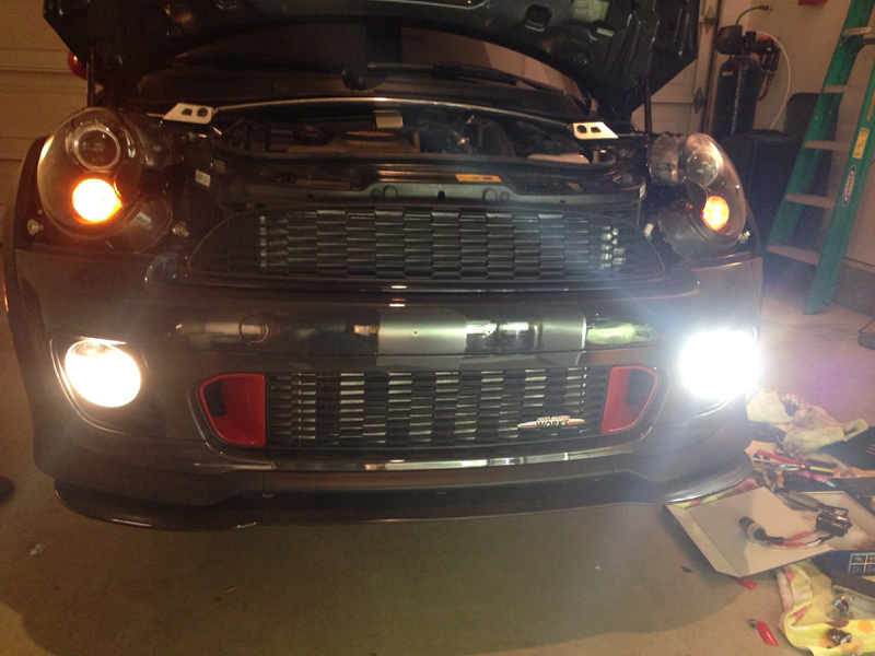

Super easy. Get burger running in the Kelvin you want. Plug and play and NO error codes. I did mine a week ago
HID on the driver side

Sorry. Order from Burger tuning and pick what color hid you want. 4300k is stock and higher the kelvins the more blue the light is

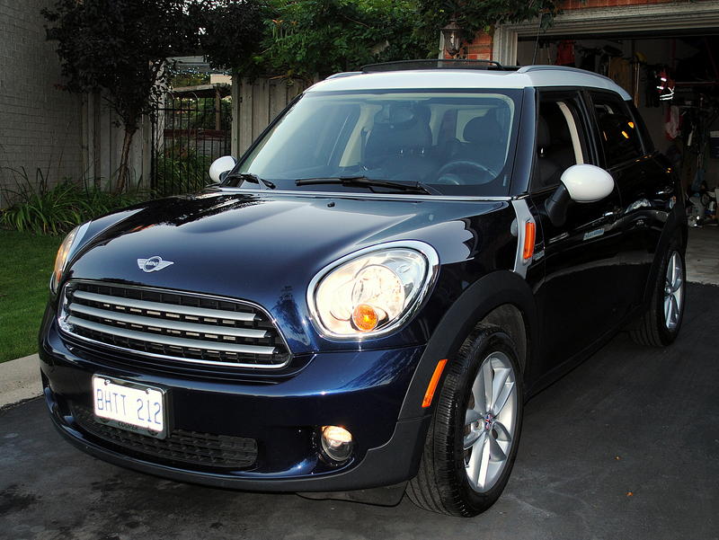

I have drl's there, just not fogs so from that i'm assuming the wiring harness is in place.

Ok that will make it easy. This would be very similar to adding the rear fog light.
You'll have to get the switch for the console (not sure what the CM dash looks like) and possibly the trim piece.
Then you may have to do some coding with NCS Expert which is not to difficult. You may have to add the fog light option to your vehicle order to make the switch work.
Non-OEM lights like the ones from Burger may or may not be easier.
Sorry for all the "mays" but I believe that this would be the general process.
