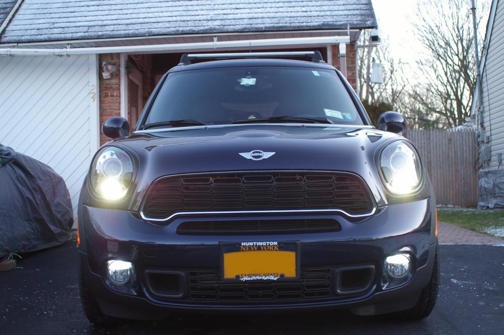

I installed led's
Note: they do flicker on car start up, but no other problems.

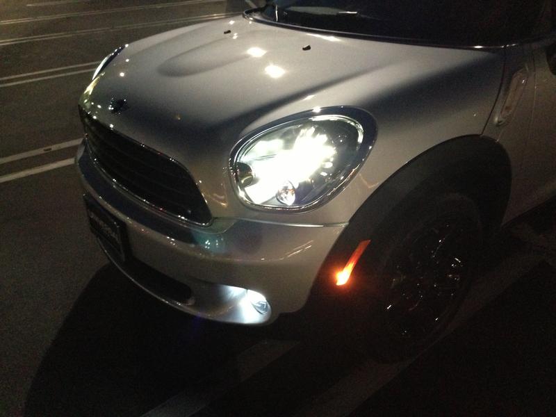

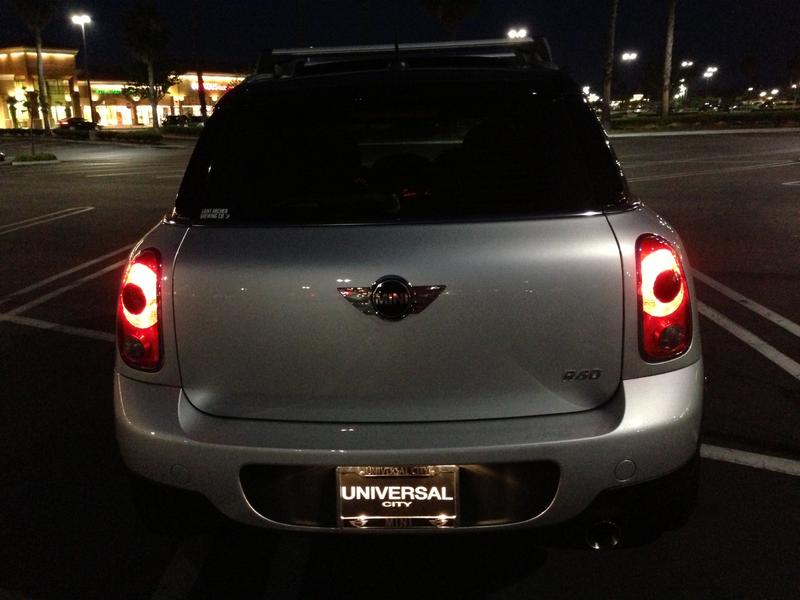

Here's a couple of iPhone (grainy) shots. Along with my new R60 badge for good measure...
Attached Thumbnails 2013 Countryman DRL LED bulbs-photo-3.jpg   2013 Countryman DRL LED bulbs-photo-1.jpg   2013 Countryman DRL LED bulbs-photo-2.jpg

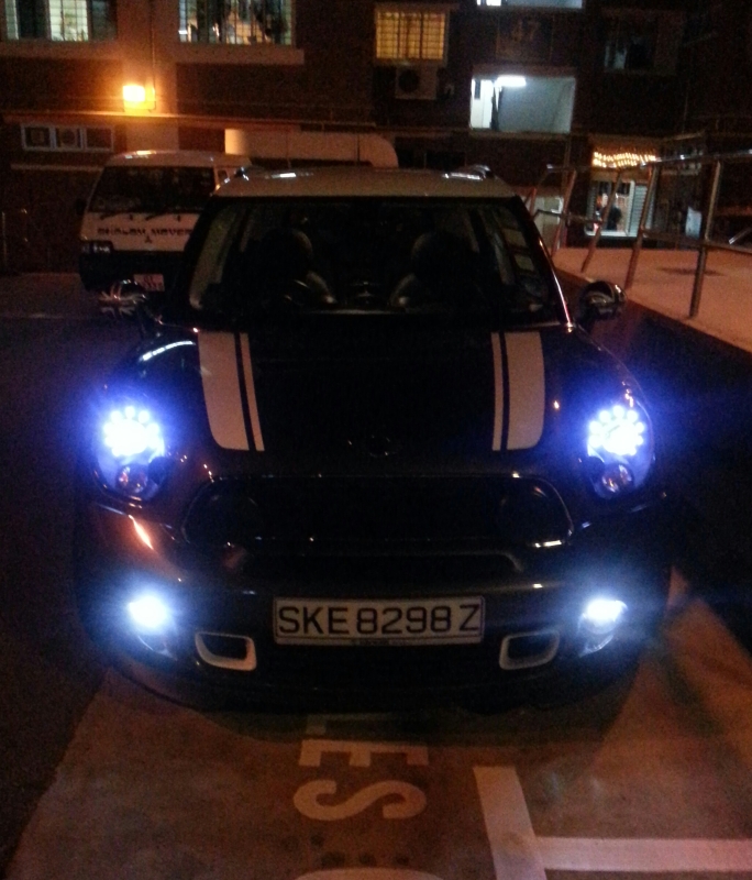

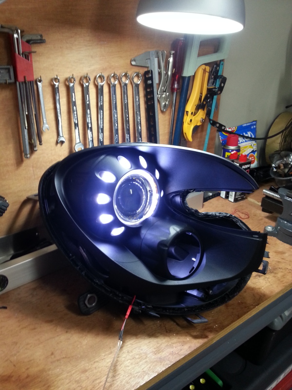

I have mine DIY with 90 LEDs stripe into the housing and is wired to the position lights. It will turn on when ever I lock and unlock the car. The pic below is without turning on the xenon.. its just the LEDs.

Roy - That looks great. I have wanted to do that since before I took delivery. Was it hard to get the headlight housings apart?
I always thought that those 8 little light ports should have been LEDs straight from the factory.
