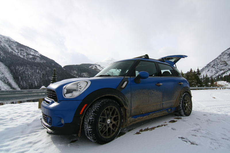

Hey what wheels are those and what size tires? I want that. LolOriginally Posted by Hoydi Cheng

TSW Nurembergings in a matte bronze.Originally Posted by vizcat
http://www.tsw.com/alloy_wheels_nurburgring.php
They're 17", 8" width, offset +35
Nokian Hakka R's
http://www.nokiantires.com/tyre?id=11949
215/55/17
- best winters you can buy imo.

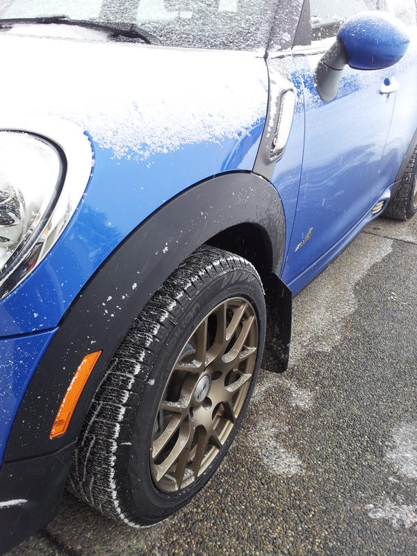

Quote:
nice. looking for wheels for snow use. these look good but concerned about an offset of 35. any chance you could post some more shots, perhaps showing how far the wheels stick out?Originally Posted by Hoydi Cheng
Thought I'd share mine too then.
thanks!

Quote:
thanks!
Don't have any on me.. I'll try to find some over the weekendOriginally Posted by tstizzle
nice. looking for wheels for snow use. these look good but concerned about an offset of 35. any chance you could post some more shots, perhaps showing how far the wheels stick out?thanks!
Quote:
MUCH appreciated!Originally Posted by Hoydi Cheng

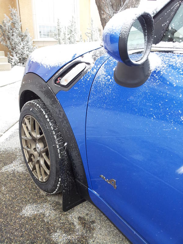

Oh my.. I totally forgot to post here. Heres another shot to see how far they stick out.
Just so you know, the setup is sweet and I love the handling and the look, but the car gets extremely dirty. I'm putting rally armor mudflaps on this week to combat it.
Quote:
thanks again. i saw you mention that. the alternative wheel i have found is a 42 mm offset so i don't think it will spare me much in the dirt department. given that, i think i'll go with your setup!Originally Posted by Hoydi Cheng
