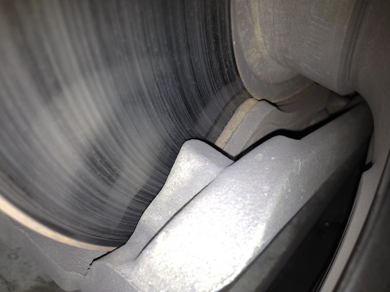

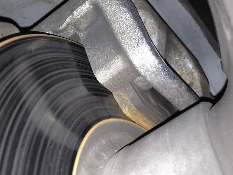

here are the pics!
First is the front left brake pad
second pic is the front right brake pad
third is the rear left brake pad.
Fourth pic is the rear right brake.
Oh! by the way, why does my rear left brake pads contains rust? and the front left brakes have some kind of a big white mark on the brake plates? Is this normal?
thanks.

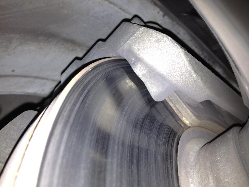

Here's the rear right side of the brake pads!
Hope you can see the brake pads. Is this worn out yet?
Haven't have time to get my MINI in for a service yet. I'll probbably do it next week or so.. or is it urgent?

cant really see the white stuff, but the FL pad is very thin, especially for 15K.
Did you ever feel any dragging? possibly a faulty caliper that isn't sliding(releasing)?
the rear pad is thicker than the backing plate. not too bad, but for 15K its a bit more worn that usual.
(stability control programs tend to eat the rear brakes to keep everyone safe & feeling like a great driver) :p
