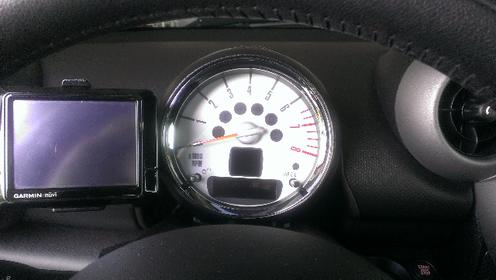

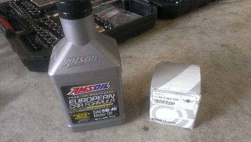

Had the resonator removed, oil and oil filter change with AMSOIL European 5w-40 and installed OEM "Chrome Line" tachometer.
I was suppose to have the second cat removed as well, but I guess the shop messed up. Back to the muffler shop I go tomorrow.

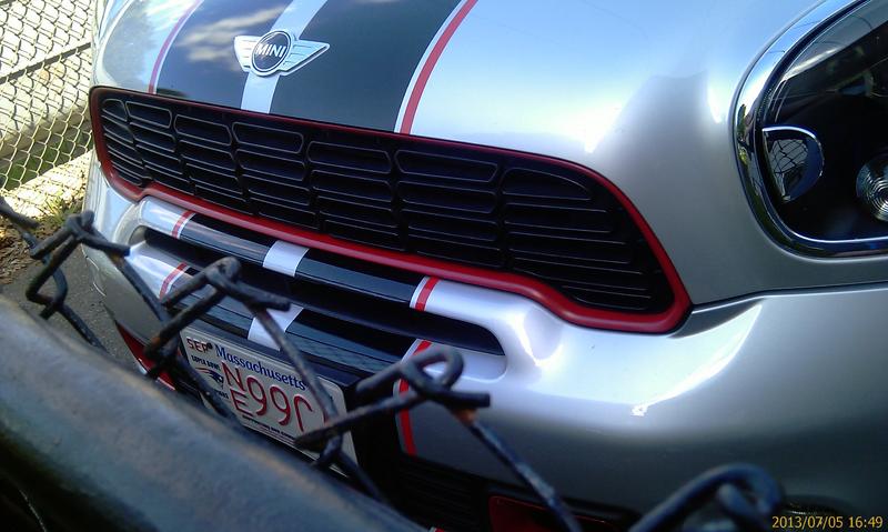

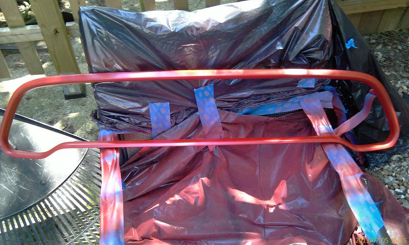

Made my chrome grill surround red using plastidip and gloss enhancer. I tried masking it but was having trouble so I ended up just popping the chrome piece out of the grill (use tiny flat heads so the 50 or so clips) and dipped it as shown in the photo

Turned out awesome!

That is awesome. I need to put on my list of things to do. It really pops on the Crystal Silver.

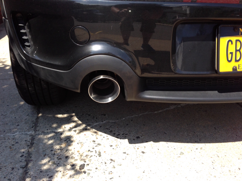

Installed Magnaflow 4" tips and removed the 2nd cat and resonator. It sounds awesome!

+1 I agree. Did the same a few days back. Just haven't got new tips yet.

The grill comes off very easy. Just 4 screws right where the hood release is. Then pop some tabs along the bottom. A little force is required but they come out.
The chrome piece is a bit more tricky. You really need small flat head screwdrivers and then go slowly and carefully prying each tab back. As you pry a tab back you also need to slip a flat head between the chrome and the black grill so the tab actually releases. There are two types of tabs also: snaps (http://www.efunda.com/designstandard...sign/snaps.cfm) and a much larger tab that doesn't look like a tab at all. The larger ones take some patience and for me required two flat heads plus one prying the chrome piece away from the grill. Save the big ones for last since they are all located on the top side anyways.

bguarino - Thanks for the pointers on the clips and order. Those are always a big help the first time one these cars when you take something apart for the first time.
