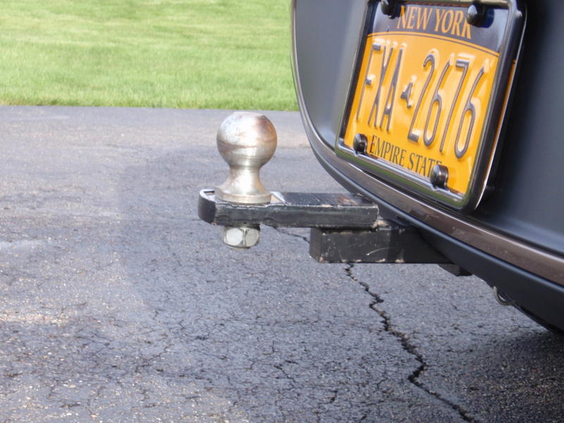

Old Apr 28, 2012 | 08:57 PM
Jimbo's Avatar
Jimbo
Joined: May 2002
Posts: 1,100
From: Endicott, NY
MINIFINI install on Base CM
Here are some pic of my MINI FINI install very neat and almost un noticeable when not in use
Attached Thumbnails Going install a trailer hitch on the R60 to do a U-Haul trailer, bad idea?-p4282005.jpg   Going install a trailer hitch on the R60 to do a U-Haul trailer, bad idea?-p4282010.jpg   Going install a trailer hitch on the R60 to do a U-Haul trailer, bad idea?-p4282012.jpg
Old May 20, 2012 | 11:44 AM
binitraveller's Avatar
binitraveller
Joined: Sep 2011
Posts: 17
From: Seattle WA
how hard was the install? looks like you have to cut out some of rear plastic?
thanks
Old May 20, 2012 | 01:05 PM
Jimbo's Avatar
Jimbo
Joined: May 2002
Posts: 1,100
From: Endicott, NY
Yes some of the black plastic on the underside of the bumper cover had to be cut but it was very minimal and most people don't even see it.
I see you drive and ALL4 S, on yours even less cutting is required as the receiver lines up with the grill work on your lower bumper cover and only a hole the size of the receiver has to be cut and your receiver cover plugs the opening when not in use. See photo below.
