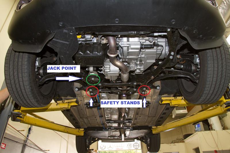

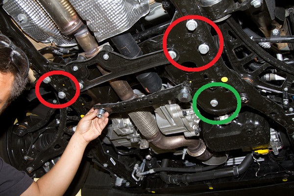

Interesting where you placed the floor jack. Do you have a photo of the rear motor mount and side of the engine sub-cradle? Or is it obvious what these are if I look under the car?
I'll see if I can get a pic. -- Thanks to 'ghamma' I used a couple of pics of his CM up on a lift to show where I placed the floor jack and safety stands.
But......the rear motor mount is located just behind the oil pan. It is a large cast aluminum piece connected to flat steel plate with a bolt head in the center. Place the jack on the steel plate. This is where you can jack the vehicle up. Do not jack on the aluminum! It should be obvious.
The jack stands were placed just aft of this area, on either side of the vehicle. Look for the tubular sub-frame running for/aft on both side of the vehicle (it is obvious as well). Just behind the jacking area there will be 2 very large headed bolts that are used to secure the sub frame to the body. This area is fairly flat. Place the jack stands there.
Attached Thumbnails Countryman S oil-change notes-lift-points.jpg   Countryman S oil-change notes-close-up.jpg
Here's a photo of that area, from when we installed my skid plate...
http://hammanet.smugmug.com/Cars/MIN...2387&k=J2R5XqT

Why wouldn't you place the stands at the jack points where you would normally jack up the car to change a tire?
I wondered this as well, will the floor jack "crush" the designated spot for jacking the car?
Yep. The lifting spot is just a pinch seam, about 1/8" thick and 3" or so long.

If you are worried you could use a block of wood to spread the force out.
