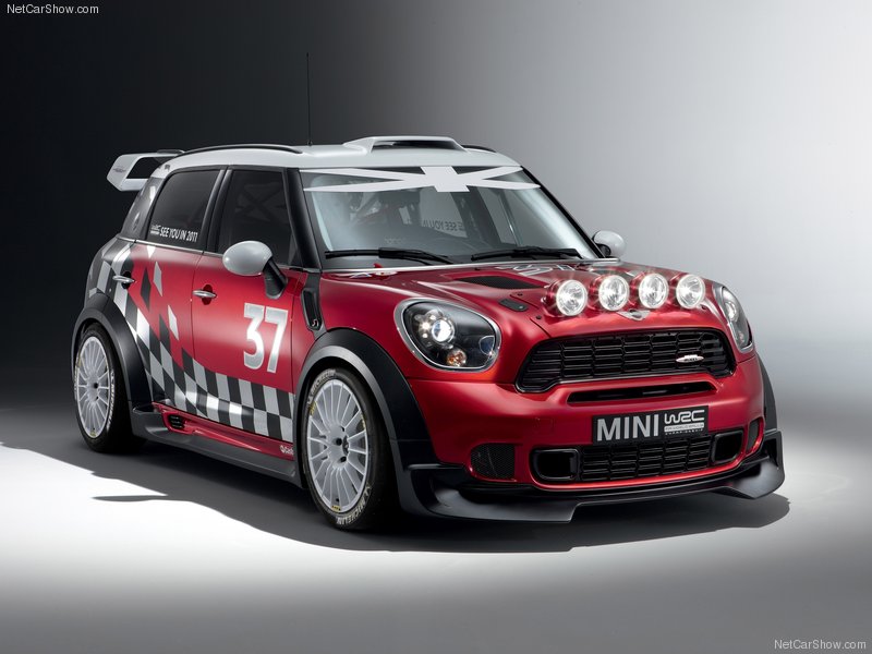

I'm not a fan of the OEM driving lights honestly. But I will get driving lights on mine one day, probably way down the road, but I'll have a replica of this setup custom made from fiberglass:
Attached Thumbnails Driving lights.  Worth it or not?-mini-wrc_2011_800x600_wallpaper_01.jpg
