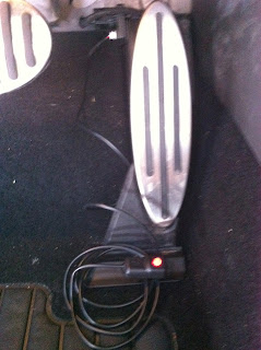

I just picked up the strut bar from VIP, hoping that it'll be here early next week, so I'm excited to see how that will go. I've also got the SprintBooster on order (again early next week delivery); if this thing does what it's says it does, this will likely be the most important mod on my car. That throttle delay is atrocious.

Old Jul 31, 2011 | 06:48 PM

From: Hill Country, Texas
Please let us know how this works out. I was thinking of getting the SprintBooster, but am unsure of it's real world gains. Will be nice to see what it will do on the CM.
I'm also pretty skeptical, but I decided it was time to finally pull the trigger and see what it does. I'll try and resist ripping the box open and installing it in hopes of getting a little bit of scientific method for before and after (but I can't promise anything).

Let us know how that works. You're right, that throttle delay is pretty bad.

I've just posted my installation of the SprintBooster to my blog. While I have no real cold hard facts, it certainly feels like it's doing what it's supposed to. Off the line Norman finally seems to respond a lot quicker than he used to. I need to come up with a way to really test it, but for now it at least feels good.
