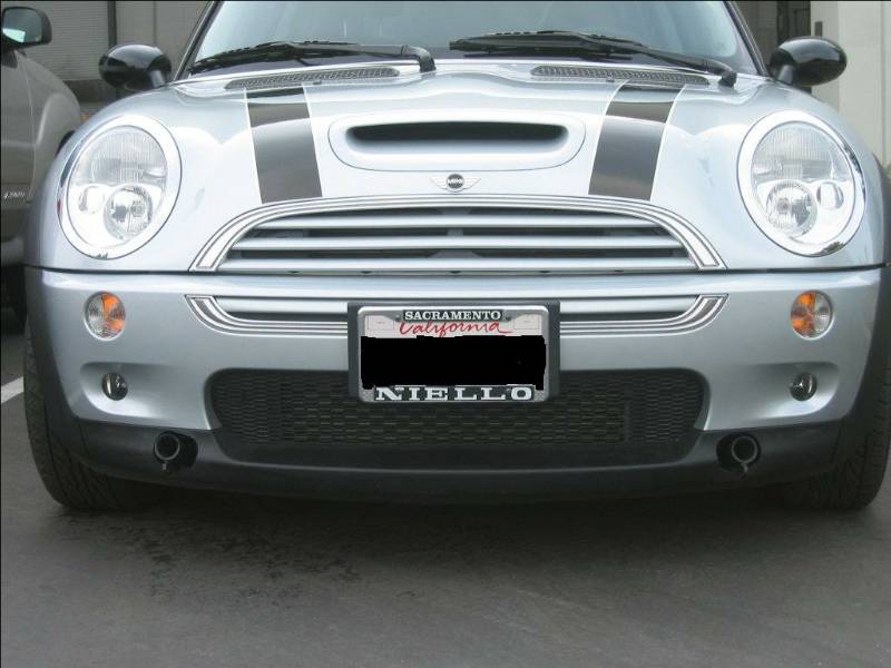

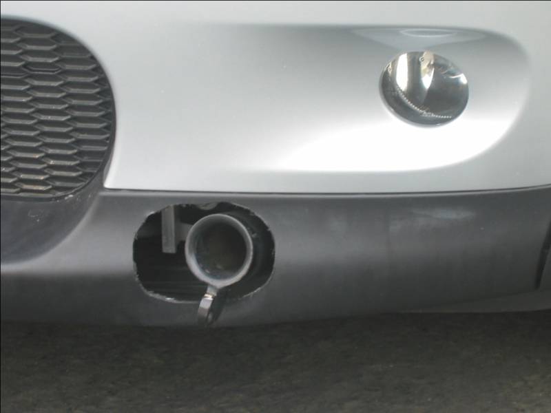

I have attached pictures of hitch bracket and light harness

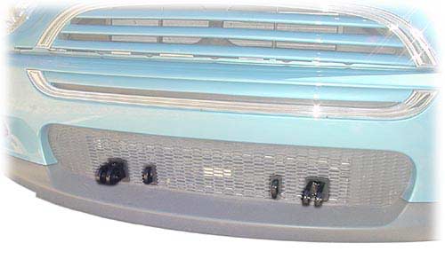

Thanks that has been a great help. I'm not sure I like the lower moulding cut as well as the Blue ox illustration through the grating. The wireing harness looks super do you have a campers world part number by any chance? Thanks a lot for your help!!
