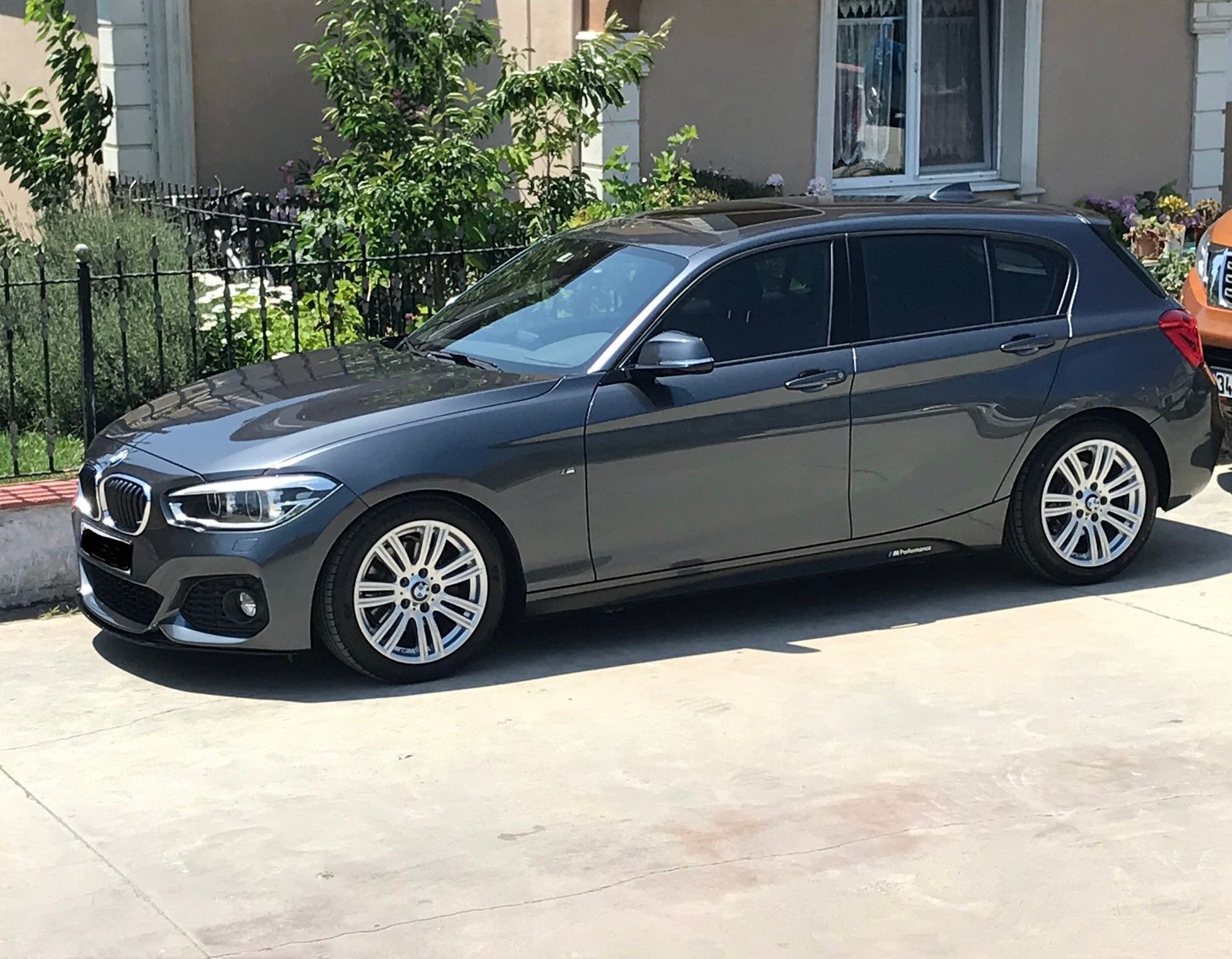

Hi it’s Floydian1973,
I have a car with the heart of the MCS N18. It’s a 2015 120i mplus. The car has the logitunally mounted N13 engine which is the same as the N18 apart from its turbo charger which is a Garrett GT1549ZDL. In stock form it produces 177ps (174bhp).
I did a number of engine mods such as a
10.8LT FMIC intercooler, Water/meth injection kit, 42mm compressor hybrid turbo (42-42), Greddy profec evc, Wossner forged pistons, ZRP forged rods, ACL bearings, ARP studs etc.
I would like to have more power, an option is to get the head port polished. What do you suggest?
