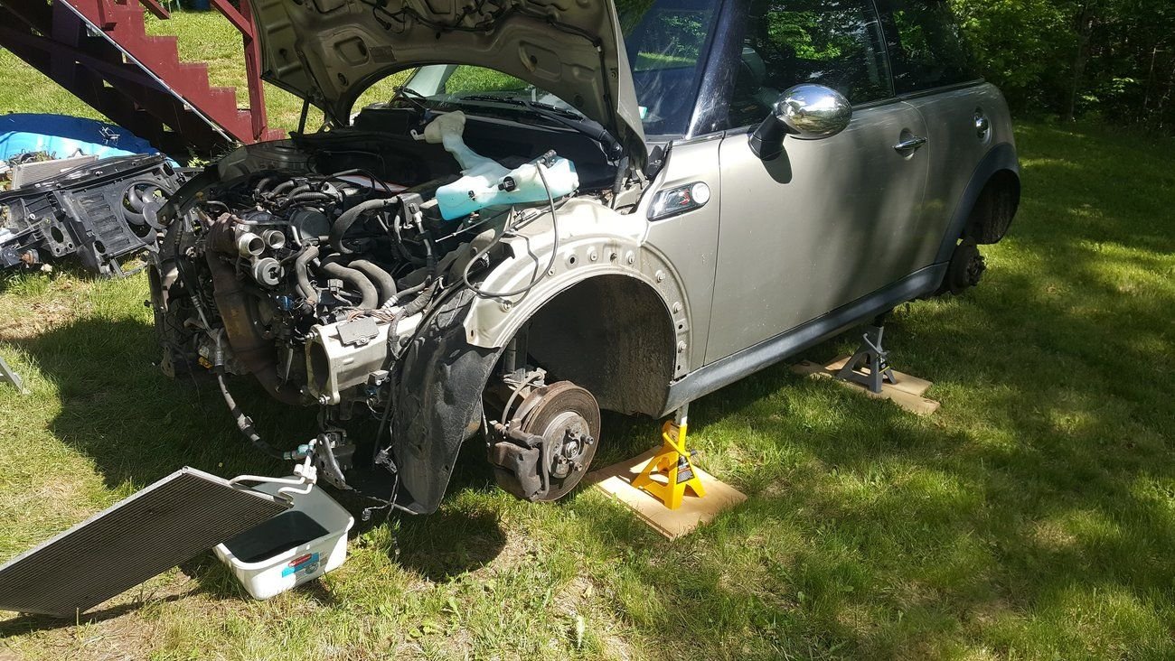

I feel and share your pain when I had to do the head job. My immediate guess is the previous owner who was a teenager redlined the engine several times and put 87 octane(regular) which you’re not supposed to.
check out the photos on what I’ve done 3yrs ago just to gain access to the head(NOT FUN). Ever since I’m putting in mid grade gas(89 octane), it is running beautifully ever since and still now.
