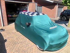

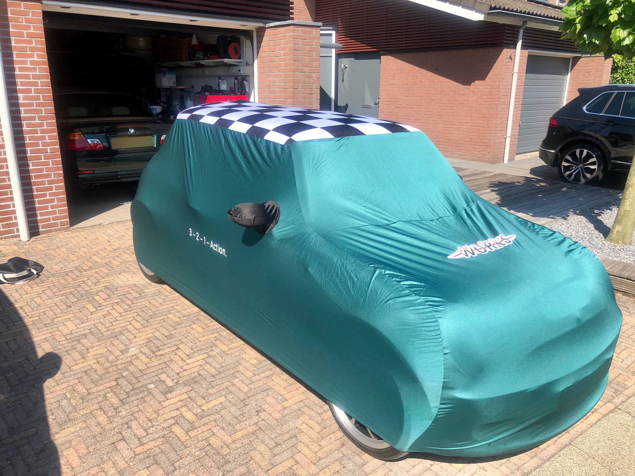

I "only" have these covers with my car:
The red outdoor one with old style logo
And the green indoor one with also the old style logo

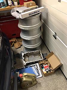

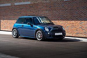

So.. now that almost every JCW part is fitted. I felt the need for some more power...
Ordered some parts which got delivered in the last weeks, now it's up to me to fit all of them.
What i've got:
- Schrick by Krumm camshaft
- Kavs 16% pulley
- Bosch 550cc injectors
- TPE Chargepipe
- GP intercooler
- M7 82c thermostat with alloy housing
- Baffled sump plates
After that i'll book it in for a custom tune on the dyno and i'm hoping to see around 250hp
oh yea and the wheels you see in the picture... I managed to find a original set of AC Schnitzer wheels!

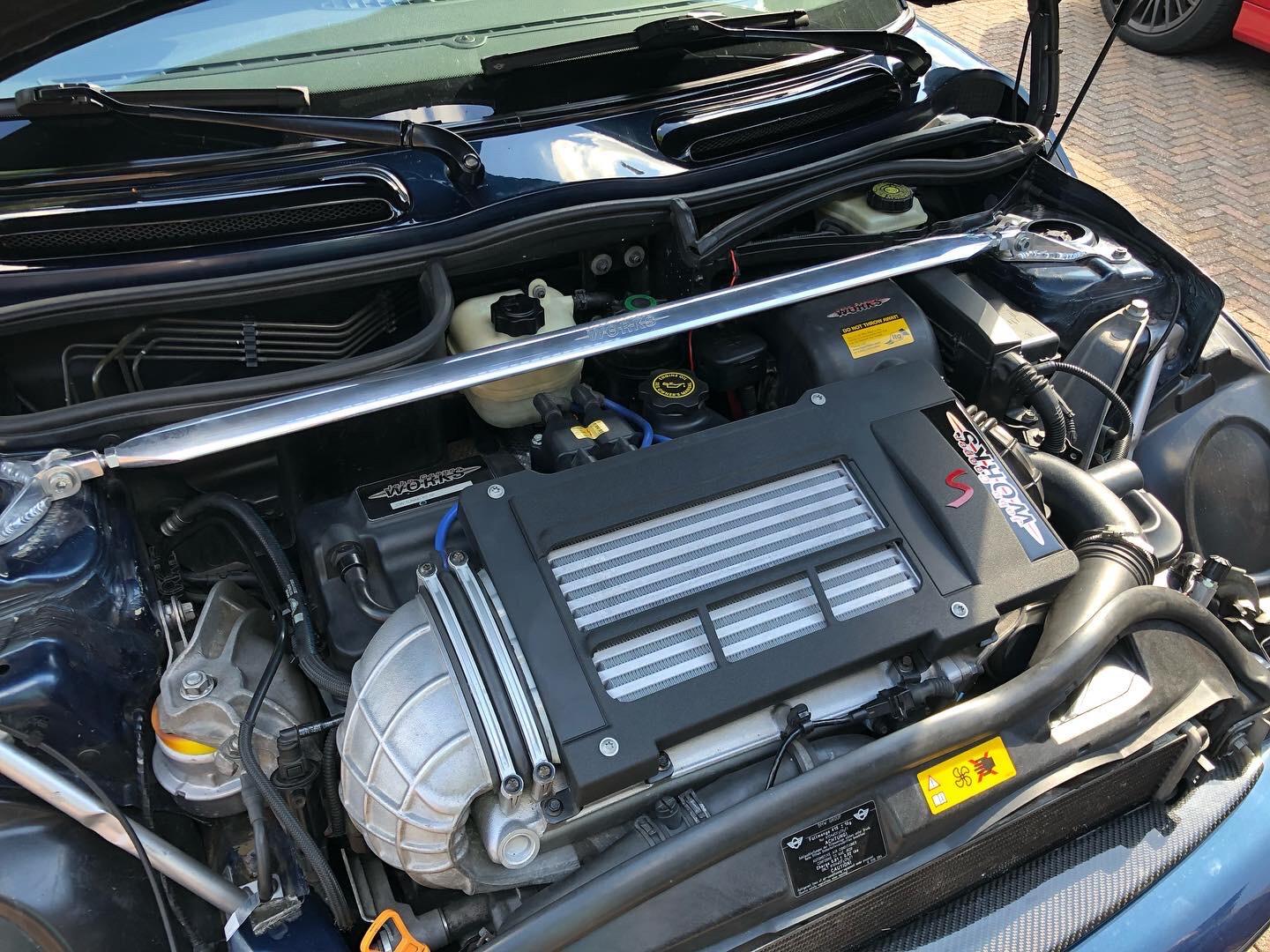

So over the last couple of weeks i've fitted some of the parts from the earlier post.
First of all I fitted the Schrick by Krumm camshaft, GP intercooler and 82c thermostat and since i have the X4datalog software specific for the R53 i've made some logs before and after to compare them.
Did som WOT runs in 3rd gear and some regular driving. The biggest differences i've seen are the following ones:
Boost went from 14.7psi to 13.6psi, I expected a drop in boost due to the bigger volume of the intercooler and of course the camshaft. So I "lost" 1.1psi on boost.
Coolant temperature was in all the before logs between 91 and 95 (195 to 203 fahrenheit) now it's just 83c (181f) and when i push it hard it went to 84 (183f)
Which due to the oil cooler on our MINI's also results in a lower oil temperature before the thermostat i was always around 100c (212f) and when i pushed it, it went to 115c (239f) now i'm at 95 (203f) when pushing 100 (212f).
Now the intake temperature i wanted to get the best comparison between stock en GP intercooler so i did 6 runs within 20 minutes, 3 with stock and 3 with GP. It was 23c (73.4f) outside temperature.
The stock intercooler couldn't get the IAT under 32c (89.6f) and at WOT it rose to 60c (140f) after fitting the GP intercooler the IAT was at 27c (80.6f) and rose to 52c (125.6f) at highest.
So over all a drop of 5 to 8c in IAT (41 to 46.6f)
The camshaft is a really nice one, much more power in low and mid range, the higher revs too but it feels less because of how powerful it is at the mid range revs. Really pleased with the results!
Also the GP intercooler looks so nice under the hood

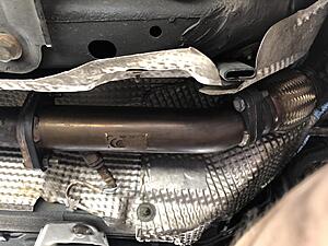

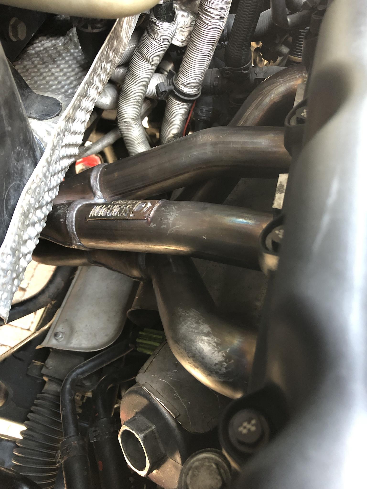

And last week I fitted an Scorpion exhaust manifold. It's a 4-2-1 version with decaf pipe but a sports cat is on it's way.
