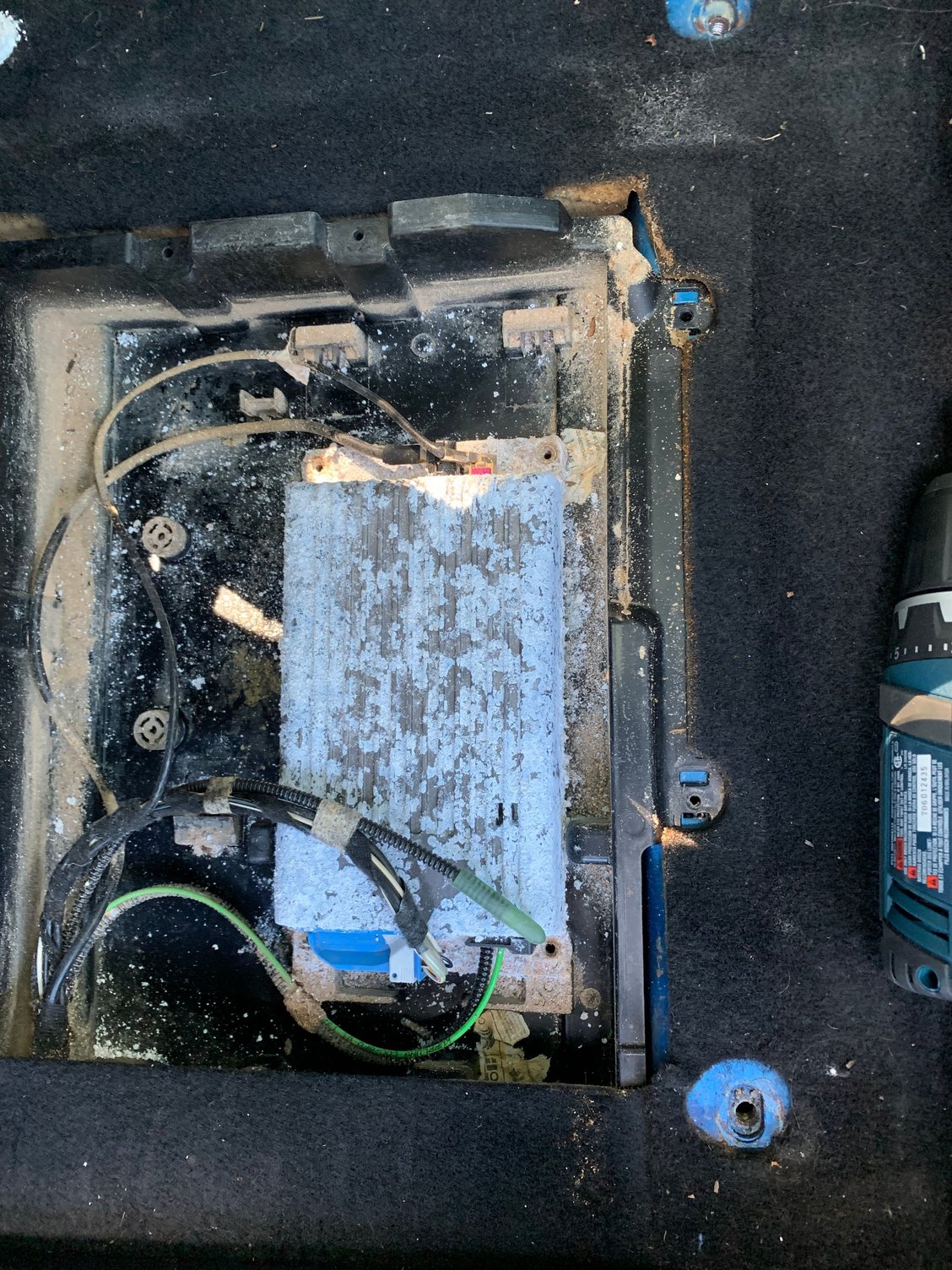

Yep, mine did come from Northwest MINI in Tacoma. The interesting thing about the service history is all the common problems you see in the R56 N14 turbocharged cars happened to mine while it was in Massachusetts. Mine had the death rattle at one point but was fully repaired by the Boston MINI dealer. The Bluetooth and AUX didn't work when I got the car and I discovered on Saturday that the whole bluetooth module was corroded so badly that I had to vacuum out the whole area. That module was nowhere near recoverable.
This is after I vacuumed out most of the corrosion from in the bluetooth module compartment
Same time, different view

I'm very happy to hear that Northwest MINI, the dealer where my car came from, takes great care of your Countryman. Most of the weirder problems that have occurred with my car have been throughout the three years that it's been in Massachusetts though. At some point someone (I'm not sure who) put in an extra "1" on the previous owner's title so the milage on the title read something like 1,113,083 when in reality it should have only been 113,083. Now there's a title discrepancy when I registered the car but I'll get that fixed because I have a lot of service bills which have the mileage of the car when it went in and out of the Boston MINI dealer. Someone at some point hastily repaired the valve cover breather tube with some really cheap silicon crap that looks like it costed no more than $10. The car threw a check engine light once a new hole showed up in the breather tube but that's been all fixed. I think the most unusual problem my Mini has had is that water leaks somewhere on the underside of the car so the carpet of the driver's side rear seat gets damp after some rain or a car wash. I couldn't figure out why my bluetooth and AUX wasn't working until I took out the module and discovered that it had been completely corroded. Here's a picture of what it looked like before I replaced it:
Yeah, there was no way this thing would have been salvageable.

It is most likely the sun roof drains. They clog with debris and the hose falls off, particularly the front driver side one and leaks in the kick panel, where the electrics are. If the hose is off on the top, glue it in. I use gasket sealer.
Your issue is showing a long time leak!
ps. You can blow out the lines, but too much pressure will blow the hoses off.
