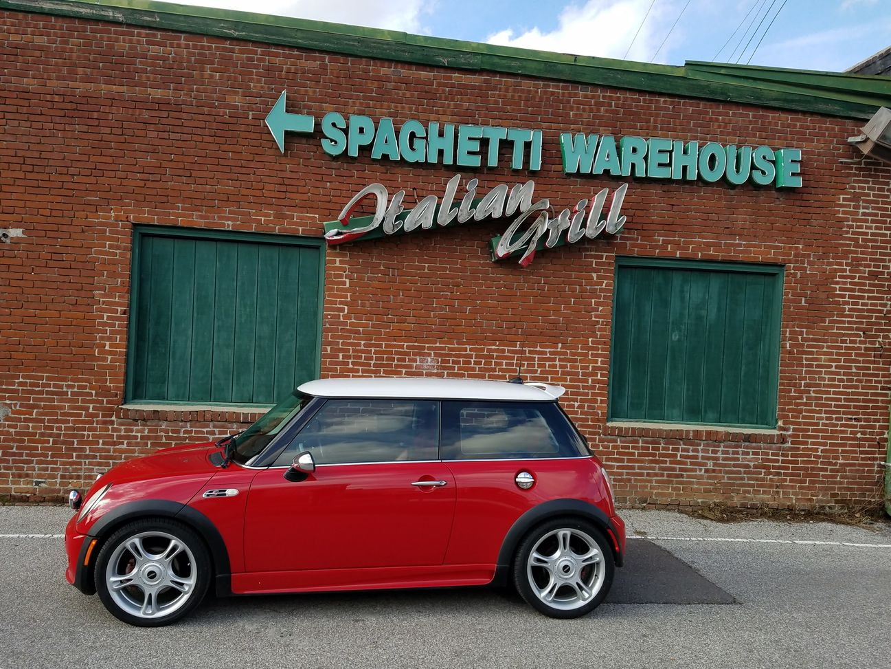

Here it is. A few warts as I said but it won't take much to bring it back.

Welcome!
Get over and join the MC40 Owners Group as well.
Great looking car... I'm kind of partial to them... go figure right?

Welcome.
Looks pretty good. We keep the MC40 Decals in stock for you.
