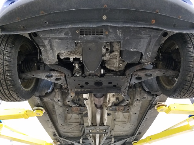

New owner of this project mini.
2006 mcs s r52
110k on the dash.
Has a couple issues, biggest being a P0741 code and hard 1-2 shifts (cold or hot).
Plan on changing the trans fluid a couple times to see if it goes away.

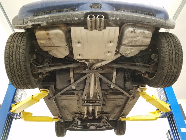

Is it possible to tell what I am going to need from the picture of the power steering reservoir?

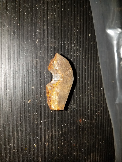

Then on further inspection I came across this wedged in a little space by the pulley!
Bolt that secures the motor to the motor mount...

As for the picture, it's hard to tell because it might be from other problem areas, but it does look like the return and suction line are coated in something. Inspect around the clamps shown in the image by the p/s res. and see if it looks like newer fluid is originating from that area. The cleaner the fluid, the closer to the problem area you are. You can clean up the area and then keep an eye on it for about a week to see where it may be originating from, but it may be #1 and #11 that I posted above.

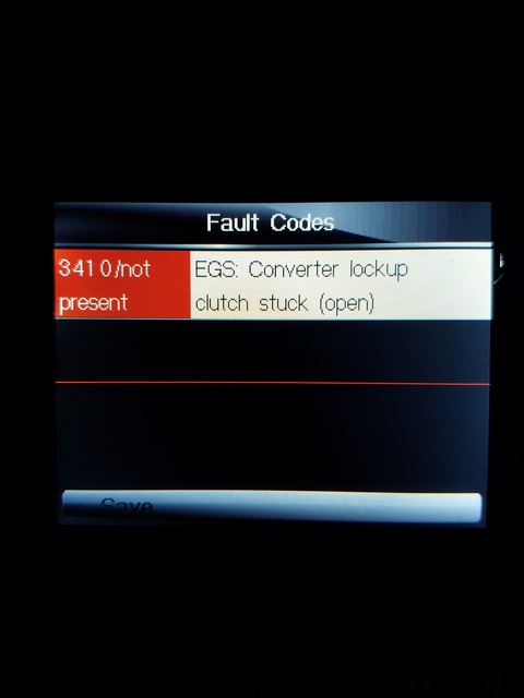

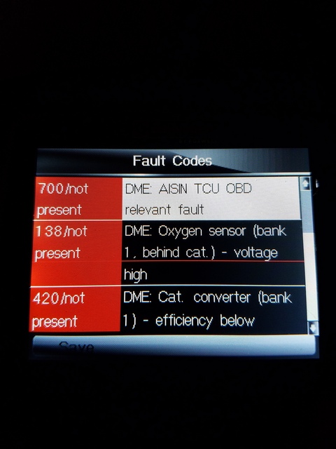

Got my scanner(which looks lIke it has an issue with the screen)... but i got some info from it at least. Now I think I need a catalytic converter based off of the 2nd 02 sensor (which I just replaced because of a p0138 code).

New valve body from revmax fixed the shifting issue and new power steering lines fixed the leak. Now I just have to install the new control arm bushings. Very fun car to drive...can't wait to put the top down and a nice hot sunny day. Cold weather is driving me nuts.
